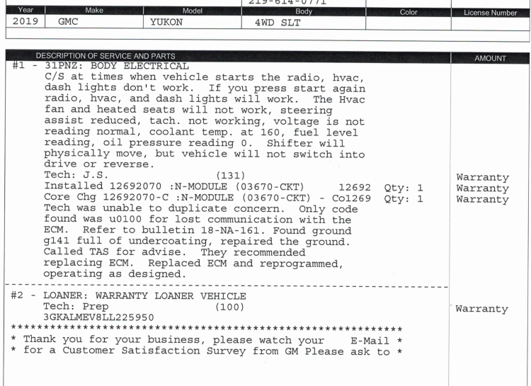

I finally received a call back from GM Customer Service.  Apparently they spoke with the dealer, and the dealer told them that the fuse block wasn't receiving power, which caused all of my problems.  I told the GM employee that the GM dealership, although they performed the TSB, informed me that they didn't find anything out of the ordinary in regards to the connections between the battery and the fuse block, therefore I am not confident that I will not experience this issue in the future.  Also, how do they know what was going wrong, because in their report, they were not able to reproduce my problem!  Also, nobody has had any interest in viewing my video thus far, which definitely confirms the issue I was experiencing.  My main concern here is being out of the 36,000 mile bumper to bumper warranty in less than 1,000 miles.  I'm asking them for some sort of guarantee that if this problem arises in the future that it be covered since I reported it prior to the expiration of the warranty.  I also mentioned that the TSB mentions zilch about the transmission not wanting to shift into any gear.  I'm calm and treated the customer service representative from GM very friendly, but overall, they know very little about what I am talking about. I also pulled the battery from the vehicle and took it to my local Advance Auto Parts to test it, who verified once again that it is in good condition with, I believe, 732 cranking amps. Considering I have had the battery tested at three separate parts stores, I would have to assume that it is not at fault here. By the way, whoever placed the single battery location at the passenger firewall should be questioned.  What a pain in the arse location, mashed in there between the coolant reservoir, fender, and A/C lines, and the firewall.   I can't imagine how difficult it would be to replace in some parking lot with frozen fingers.  Talk about a god awful nightmare if it has to be done again in the future, without the comforts of my very own private garage!  I have to comment that this is the absolute most inconvenient battery location that I have ever had to work with in my experience!  I also went through all of the 5 battery connections including removing the entire fuse block on the driver's side of the vehicle and not finding anything wrong with any of the pins.  Nothing is bent or broken or anything and everything looks immaculate to be honest, as one could consider normal on a 2019 model year vehicle. Once again, I highly recommend to each and every one of you with a similar problem to CALL GM Customer Support.  Some of you have gone "quiet" which is typical of an internet forum, but that's all I've got so I hope everyone here with a troublesome GM vehicle never gives up!
Edited by BlaineBug
Today on Friday, the issue presented itself again.  I was fortunately able gain control of the vehicle after multiple restarting attempts so that I could drive it to the same dealership that it was at on January 13th, rather than having to be towed in again.  This just happened about an hour and a half ago.  All of the symptoms that I described last time happened exactly the same again today, with the exception that after multiple restart attempts I was able to drive away just as if nothing happened.
Once again, they checked the codes and nothing was stored.  However this time more people were involved at the service desk.  A staff member was looking through the service history and noticed that it came in for some electrical issue in Missouri but that they didn't know what for and would look in to it further.  I do know that this vehicle was from Missouri as I saw the Missouri title from Carmax when I bought on December 10th, 2019.  I wish the dealership would have dug deeper at the service history the last time I was in.
