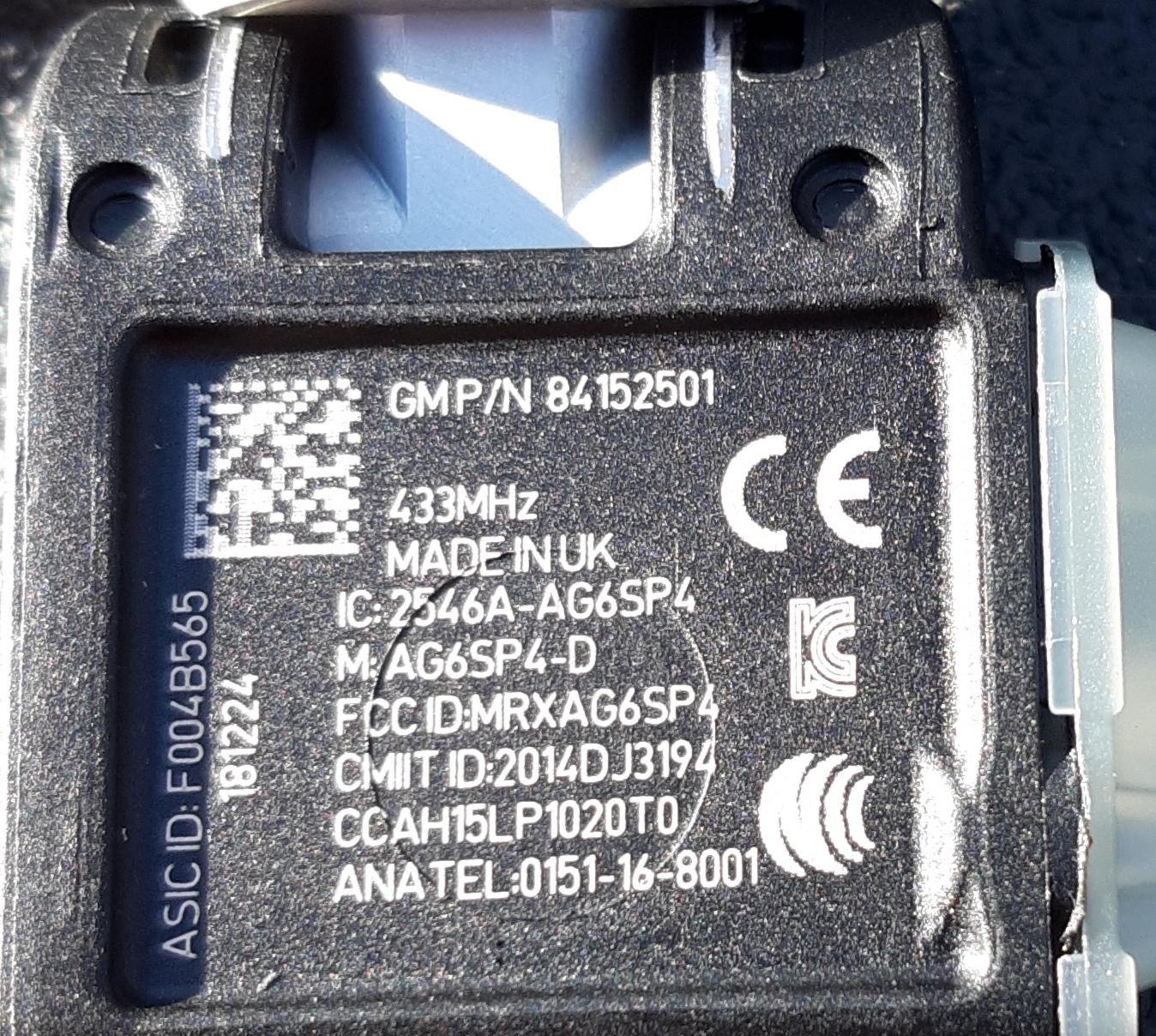

this is the part number from one of the tpms from the truck..this is what is included with the truck if your dealership ordered it correctly...you can see the frequency right on it.  tomorrow morning i am pulling my trailer to discount tire to have them installed so i can program them to the truck...i bought a set of 4 of these on fleabay for 50 bucks so not to bad of a price.  in my case i am getting 4 sets since i own several large trailers i want to monitor...as for programming them you do not require a special tool to program them..
