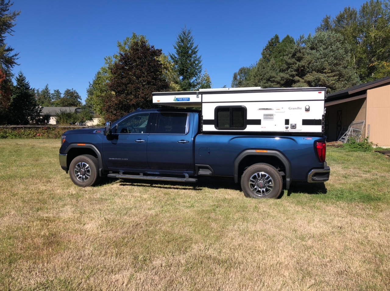

I just upgraded from a 2020 GMC 1500 to a 2020 Chevy 2500 HD Duramax and love it. I made the move as I have to tow a heavy boat/trailer, it's only 23' boat but it's 7200# dry but with it and the trailer I was pretty much at max of the tow rating on the 1500 and now it's like the trailer isn't even there.
