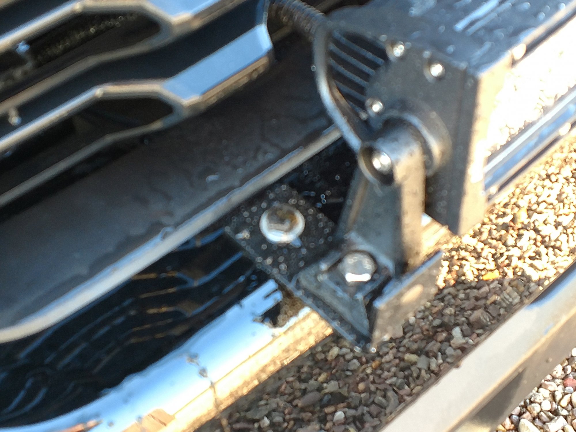

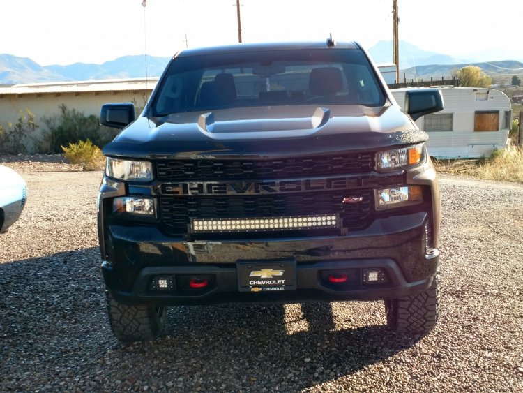

So instead of paying like $1200 for some over priced light bar exact fit kit I did my own.I bought simple 90° angle brackets from Amazon and a 32" curved light bar and wiring harness from Amazon also,Nilight brand.I have used their lights before and even though they are inexpensive the freaking work great.I spent $28 on the lower led fog lights and about $83 for the light bar,harness and brackets.Install wasn't tough,just measure,drill and fasten.The wiring harness is all put together,just ground,fish through and secure,then power to the accessory power post on the battery.Easy.On the fog lights I unbolted(3 10mm) bolts from the factory plugs ,cut them out with a Dremel and they went right in.The switches are on the lower dash panel,left side,to the right of the park brake switch.Easy install,I didn't pay $275 for the factory fogs kit and $1200 for a specific fit kit.I did try to put it behind the grill but there isn't enough room for it.Maybe a different type of light could work but I like how it turned out.

I tried a 32" curved bar from Nilight and it was too thick plus you would have to fabricate brackets.I chose to put mine on the bumper,drilled 2 holes.There are very expensive kits out there,like around a $1000+,seems like overkill for a light.I did mine for $83.
