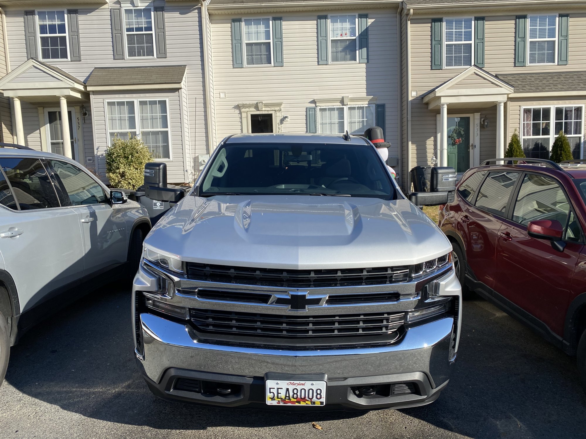

You're welcome.
So regarding our existing harnesses plugging in, yes they do. Identical plug and play. However the factory harness does not have all the circuits for all the mirror features. That's where the replacement harnesses come in. Depending on what model you have, there are several part numbers GM has put out. They don't seem to be available though since I spent all day Friday calling around and the numbers exist, but are not available to order.
Yes, it does suck they don't power fold. However, as time goes on, we should be able to find part numbers for mirrors that do. The mirrors I bought are on the GM Accessories site, and are pretty basic. However, you can spec a new 2020 with an LTZ or High Country trim w/Tow Mirrors and it says it can have power fold, 360 vision, etc. So they do exist. They also have chrome caps on the higher trims as well.
On a side note, these mirrors fold much easier, yet still have all the tensile strength as the K2 Tow Mirrors did. When you push to fold them, the mirror makes an upward then backwards movement and folds pretty close to the truck.
I'm sure all the options will come available soon enough.

So the first link you posted is actually a modification for trucks that came with either puddle lamps or tow mirrors from factory. That adapter fuses together two circuits and allows those lights to come on when you backup or when you unlock your truck or turn on the cargo lamps. It does not help if you did not have puddle lamps or tow mirrors from the factory.
The second link is indeed what I need. However I finally got a hold of the right person at GM yesterday - these parts are not available yet. No location in the entire country has them yet because they aren't being manufactured. Well actually that's not totally true - the assembly plants have them for the 2020's they are currently building, but they are not yet available in the parts department.
