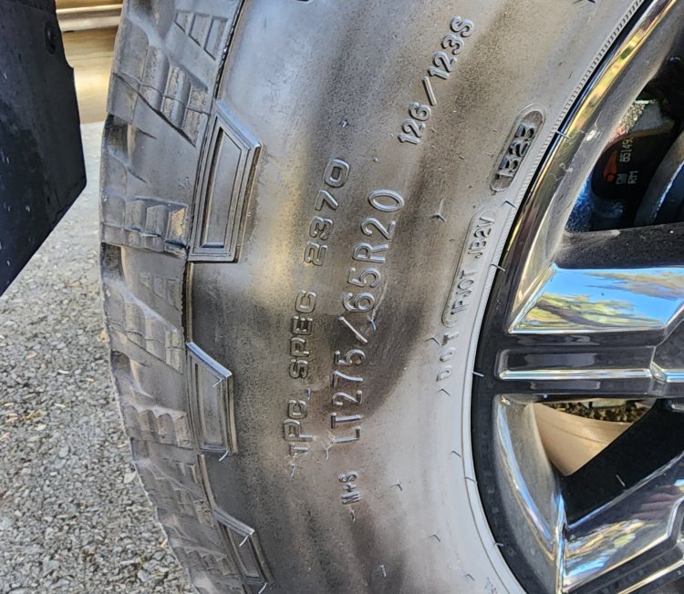

IMG_3562.HEICIMG_3561.HEICI noticed on my AT4 that the Trail Runner tires have developed a bulge in the sidewall. I am putting some Duratracs on the truck, and going to see if they will warranty the tire.
 Posting this so others can be on the lookout.

Well the forum wont let me post any pics now, so I guess people can just keep an eye on their sidewalls, I will try to warranty the tire and see how that goes.

On 12/23/2019 at 9:01 PM, twofish said:
Update, no warranty on tires. Talked to Discount Tire they said "factory tires have no warranty". Called dealer, basically told same thing "sidewall damage not covered".
Did put the Duratrac tires on, they work amazing in the snow and ice.
FYI, that's how most tires come. Its not a defect of the tire. That is where the nylon for the sidewall is overlapped.
Michelin don't have that because they cut it out of a sheet instead GoodYear cuts off a roll then turn it onto itself.
The tires that come on the trucks may have the name brand and model of a store tire but they’re not alike, very different performance and durability. I’ve never kept oem tires on any of my new vehicles cause they’re garbage, many better tires out there and if you’re on a budget, Wildpeak AT3’s have good reviews
