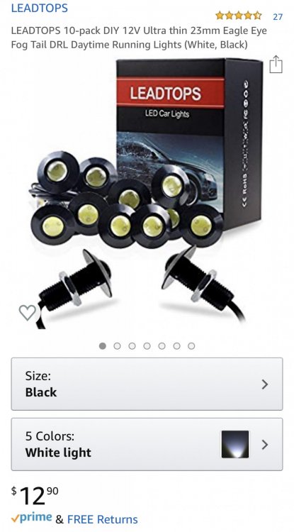

How bright are they? I was looking at images in Amazon from the seller and they looked too bright. What do you think?
These are the ones I used.  Different than the OP.  I think they are about right for brightness.  Hard to photograph at night but in person, they are separate and distinct but come no where near headlight bright.  Q&A list them as 110 lumens and 9 watts.  In the daylight, not all that visible at all.
YITAMOTOR 10PCS Eagle Eye LED Lights Amber Daytime Running DRL Light 18mm Ultra Thin Waterproof Aluminum Shell Car Motorcycle Fog Tail Backup Reverse Light https://www.amazon.com/dp/B07CWPDZKJ/ref=cm_sw_r_cp_tai_SoTbEbGXP37WP

I ended up using fuse 42 to tap off of, right parking lights vs left, because the fuse tap I used had clearance there. I included a pic of the fuse tap I used and the lights I installed.
