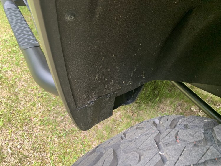

It's not necessarily true that 35's will fit all the time though.  These rims must be 20x9 - with relatively little offset.  I have 20x10 with 35x12.5's on mine and trimming was required even with the 3" suspension lift.  Had to trim the from anyway after putting the new bumper on - sits higher in the wheel well
Planning on a bumper build anyway. Is the forward end of the front wheel well, where trimming is usually needed? Planning on only staying in the 35 range for towing anyway, but not crazy about the stuffed look. Thinking about going with cooper's again.
