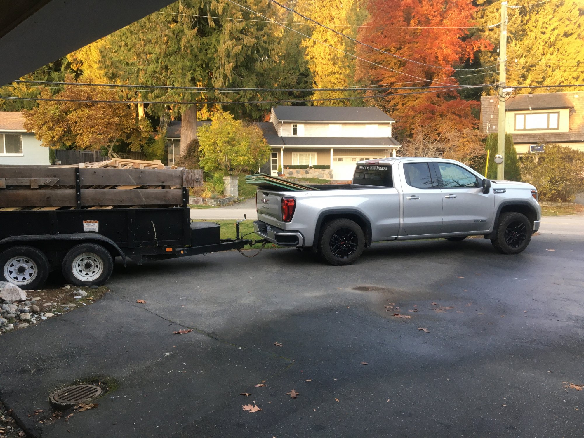

So I went to move my RV with my new T1 2019 Silverado with the Max Tow package. Previously I had a 2018 Silverado that DID NOT have the Max Tow package. In my opinon, this looks like an awful lot of squat for a truck that has the Max Tow package that supposedly has stiffer springs than normal.
Now granted, this is without my weight distribution hitch on. I did this to see what the trailer itself would do, and I do not remember my old truck squatting this much. This trailer weighs 7125 pounds, and has a 832 pound tongue weight. Well within the specs for the Max Tow Silverado.
I'm honestly starting to wonder is it possible even though I have Max Tow they messed up on the assembly line and put the wrong springs/shocks on? What do you guys think?

I have a 2019 Sierra with Max Trailering package and have towed my 8000 lbs trailer (dry weight) with ease numerous times this summer.  The picture you have is about the same squat I have when the weight distribution bars are not engaged.  When the weight distribution bars are engaged it is nearly level.  Night and day difference between my 2019 Sierra and my 2015 Sierra that did not have the Max Trailering package.  I took my new truck and trailer to an RV dealer to ensure the hitch and weight distribution bars were properly set up.  As a side note I did replace the factory jounce stops/bumpers with Timbren Suspension Enhancement System

first off, I think you are looking pretty level for not having your load bars on, maybe a little trailer high though. with the load bars on it should be level

The 11,400 number will be impossible to get to as you will overload something somewhere. Probably your RAWR (rear axle weight rating) first. My loaded 9500lb camper in the picture was 200lbs below the max rating on the rear tire with no payload other than me and more front axle bias than I wanted on the hitch. with it in full "camping mode" I had 20lbs to spare and that was with some creative load balancing in the trailer (aka less tongue weight)

I have a new NHT and I dont think the springs do any more than regular ones.  What is your tongue weight?  That is a lot of squat.  If you didnt readjust your hitch it's likely not transferring enough up front.
I plan to get air bags for mine like I had on my 2014 z71.   Made all the difference.
 I did my first tow with a bit of a heavy load a few days ago and noticed quite the sag on my max trailer 2019 Sierra.
I had a fair amount of weight in the box, a high tongue load in the trailer and I also have a leveling kit installed, which I’m sure all contributed to the sag.
