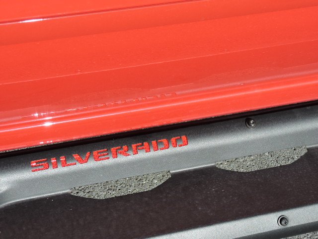

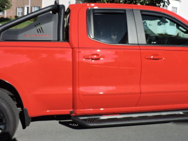

Tired of those punched out logos in the steps and sports bar? Less than $4 and you can customize to the body color, even add reflkective backing for the red and the white trucks.
Loosen the Torx screws holding the step plate to the bar and insert red or white reflective strips used for mailboxes or a color co-ordinated strip cut from the cover of a plastic foldover from the stationary section. slip behind the punched out logo, retighten screws to hold in place and it jumps out. Great as a side reflector at night. Same goes for the punched out logo in the sail of the sports bar.

I like this alot, my truck is blue but I think I might try the red, it would blend right in with the Z71 and Trail Boss logos.  So you used the Red Mail Box strips they sell at HomeDepot?
If I had a tri coat white or if I had chrome bumpers or trim I would have gone with the white. Reds come 4 per pack and need 2 per side for length, invisibly joined under the gap between two letters .

Looks good on the truck too, great idea!
