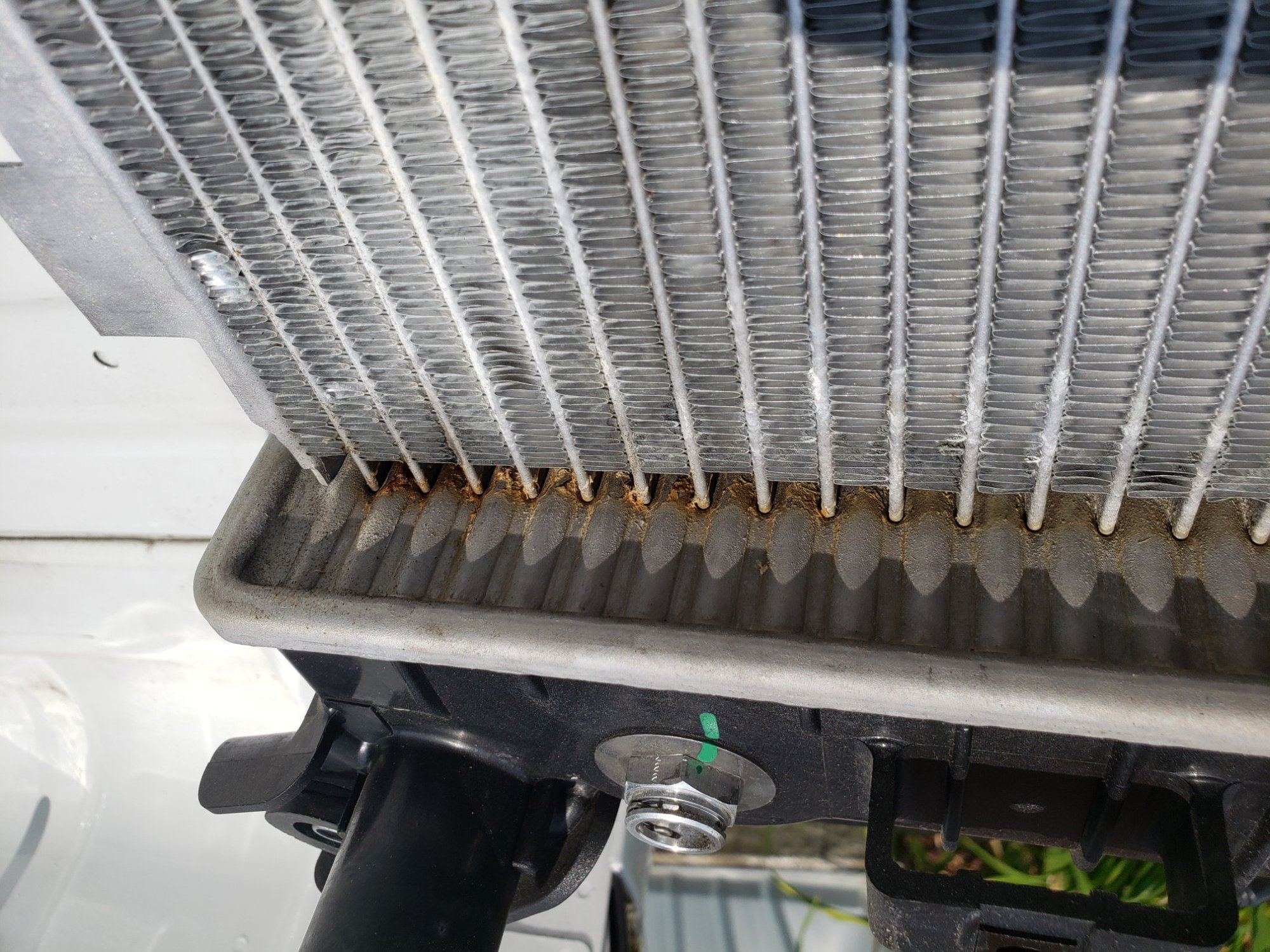

I have a 2018 that had the radiator leak as described in the TSB for the 2014s and 2015s dated January 2019. Took it to the dealer and they said they wouldn't cover it since it's not for the 2018 and my powertrain warranty only covers the water pump. Sales manager fiddled his words around to make it sound like he's "never heard this happen on a 2018 before." The mechanic also recommended I change my thermostat. Made a complaint to the NHTSA about this. Hopefully more people do so and GM might issue some of us our money back. The fact they don't consider a Radiator part of the Powertrain is ridiculous especially when you have to label this as "powertrain" under the NHTSA's complaint page.
Attached a picture of where the leak was on my old radiator.
Thought it was funny too when I asked for the old one, they had a stack of old radiators and a few of them looked almost the same as my old one, but he's "never heard of this happening on a 2018 before." Sure bud
