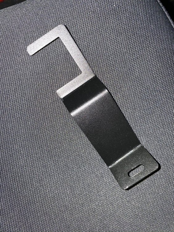

Yes.  That's the feniex bracket.  I'll try and grab a pic of mine.  I have the fusion.  It was extremely hard to get in place, but doable.  You can take the screw out, be very careful with opening the tab for the screw, but then there is no obvious way to tilt or maneuver anything to get it to loosen up.  I barely was able to inch the bracket under and into place.  I would love to know how the visor clip is removed.  Would make it so much easier to install.  Hopefully you got past this by now, but I'll snap a pic and post if I can.  The other bracket for the other side of the visor is easier to figure out, but a bit complicated still.  Take a pic or two before it comes all apart.  Again, hopefully you got this by now.
I got a couple of pics.  Driver's side.
