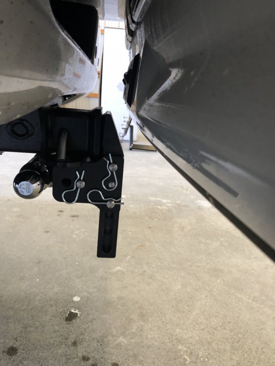

A little background on our Tailgatefix that should hopefully be available by next week if not before. Our product is designed to override the switch and lock out the inner tailgate from being lowered if you have a hitch in the receiver. It’s designed to keep the inner gate from accidentally being lowered while there is something in the receiver. If you are looking for a product that lets you use the inner gate and step the only item I know of is a hitch that will drop down 6” or lower. That will only work on lifted trucks, it will not work on a standard truck as the hitch would drag the ground .
I have my B+W Multi-pro Tow and Stow installed. I have not towed with it yet. I have a light enclosed trailer tow this weekend.
The unit is seems to be very good. Now that I have it, I appreciate its value. I didn't realized it when I ordered the hitch, but it is well worth the money for my towing needs. I am constantly towing different trailers, different drops, ball sizes. Before this tow and stow, I had a bucket of hitches with different ball sizes and drops in the bed of the truck. Now, my adjustable tow and stow stays mounted for good. With the adjustable height tri-ball, I have most every towing requirement covered with a few pin pulls.
Regarding tailgate contact -
I am 265 pounds, it does not touch the ball nor the hitch when I aggressively get on the lowered step-gate. I tend to adjust the the hitch ball fairly low, say a 4 or 5 inch drop. At that height, the step-gate clears with the ball in position to tow. However, the step-gate will hit the ball if you have the hitch ball positioned with very little drop.

Can you take a measurement from center of receiver pin to center of ball when you get a chance. Also, is there a tow rating stamped on it? the website is low on details.
