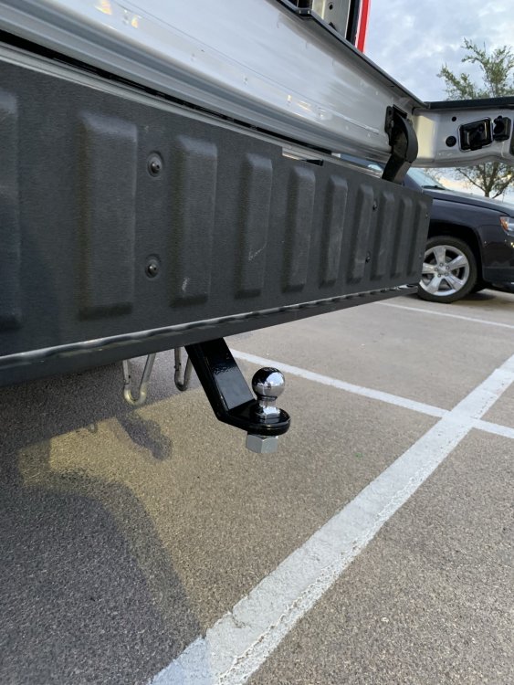

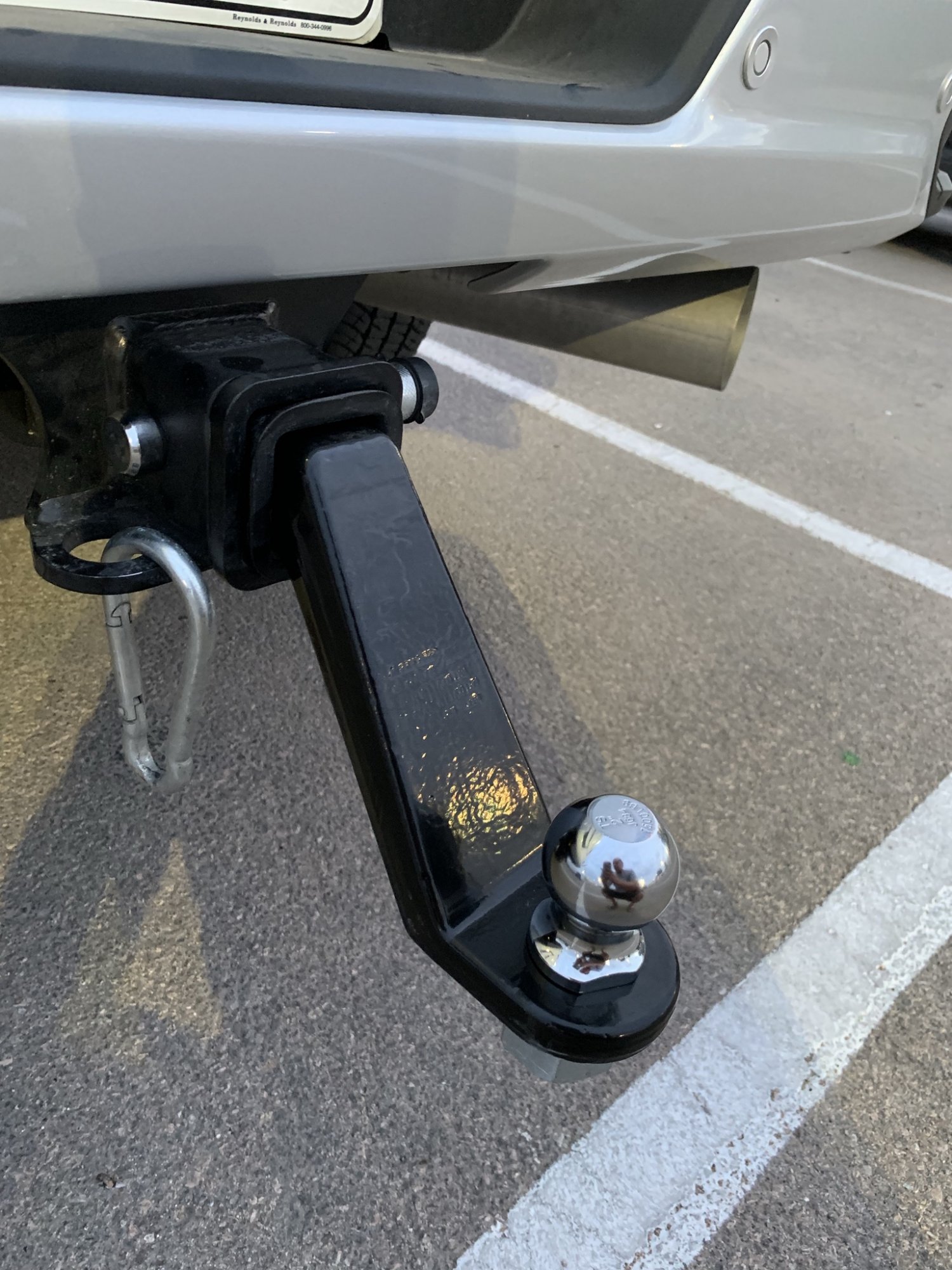

Ive posted a thread on this issue, there is a hitch that you can buy that is 6 inch drop angled and will work with multi pro tailgate.  One is Curt, other is Ultratow.  I've had it in my truck for around a month now and use my tailgate and tailgate step all the time.

On ‎10‎/‎26‎/‎2019 at 11:28 PM, In2racn said:
Thanks for the detailed pictures, very cool. Are you finding the 6 inch drop working OK for you for many trailers?  I wonder if a 3 or 4 inch drop would hit? Six seems like a big drop.
Nope my utility trailer sits damned near perfectly level while hauling my Mule Pro or mowers.  I will say it is fun to watch the reactions when I just walk up and drop the tailgate with that hitch.
