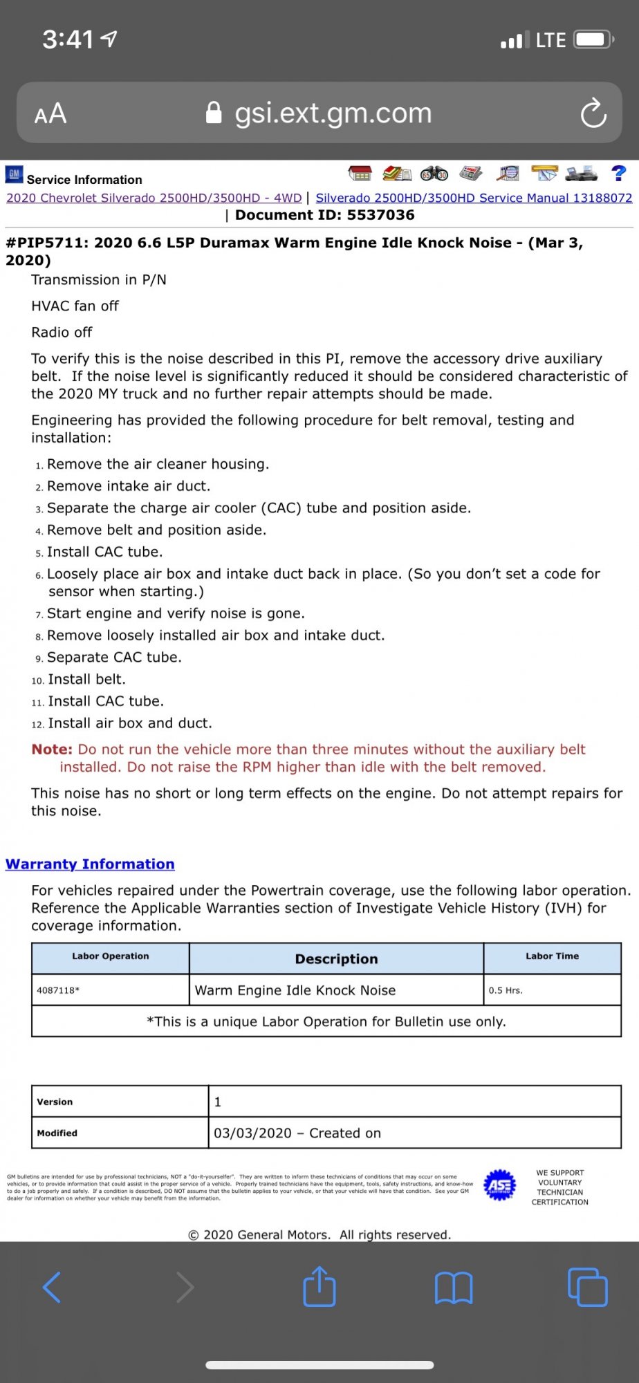

Heads up diesel knocking folks:
Quote
#PIP5711: 2020 6.6 L5P Duramax Warm Engine Idle Knock Noise - (Mar 3, 2020)
Condition: Customers may have a concern of a thumping or knocking noise coming from what sounds like the rear of the engine.
Cause: Characteristic noise being amplified by the transmission bell housing.
Correction
The noise described in this communication is audible in the interior and exterior of the vehicle but is more pronounced in the interior.
The noise is easiest to duplicate under the following conditions:
Engine at idle (about 600 RPM)
Engine oil temperature 113 - 185 degrees Fahrenheit (45 - 85 degrees Celsius)
Transmission in P/N
HVAC fan off
Radio off
To verify this is the noise described in this PI, remove the accessory drive auxiliary belt.  If the noise level is significantly reduced it should be considered characteristic of the 2020 MY truck and no further repair attempts should be made.
Engineering has provided the following procedure for belt removal, testing and installation:
  1. Remove the air cleaner housing.
  2. Remove intake air duct.
  3. Separate the charge air cooler (CAC) tube and position aside.
  4. Remove belt and position aside.
  5. Install CAC tube.
  6. Loosely place air box and intake duct back in place. (So you don’t set a code for sensor when starting.)
  7. Start engine and verify noise is gone.
  8. Remove loosely installed air box and intake duct.
  9. Separate CAC tube.
  10. Install belt.
  11. Install CAC tube.
  12. Install air box and duct.
  13.
Note: Do not run the vehicle more than three minutes without the auxiliary belt installed. Do not raise the RPM higher than idle with the belt removed.
This noise has no short or long term effects on the engine. Do not attempt repairs for this noise.
The short of it is...take it in, have them pull the belt.  Have them run it with you present if possible when the belt is off.
