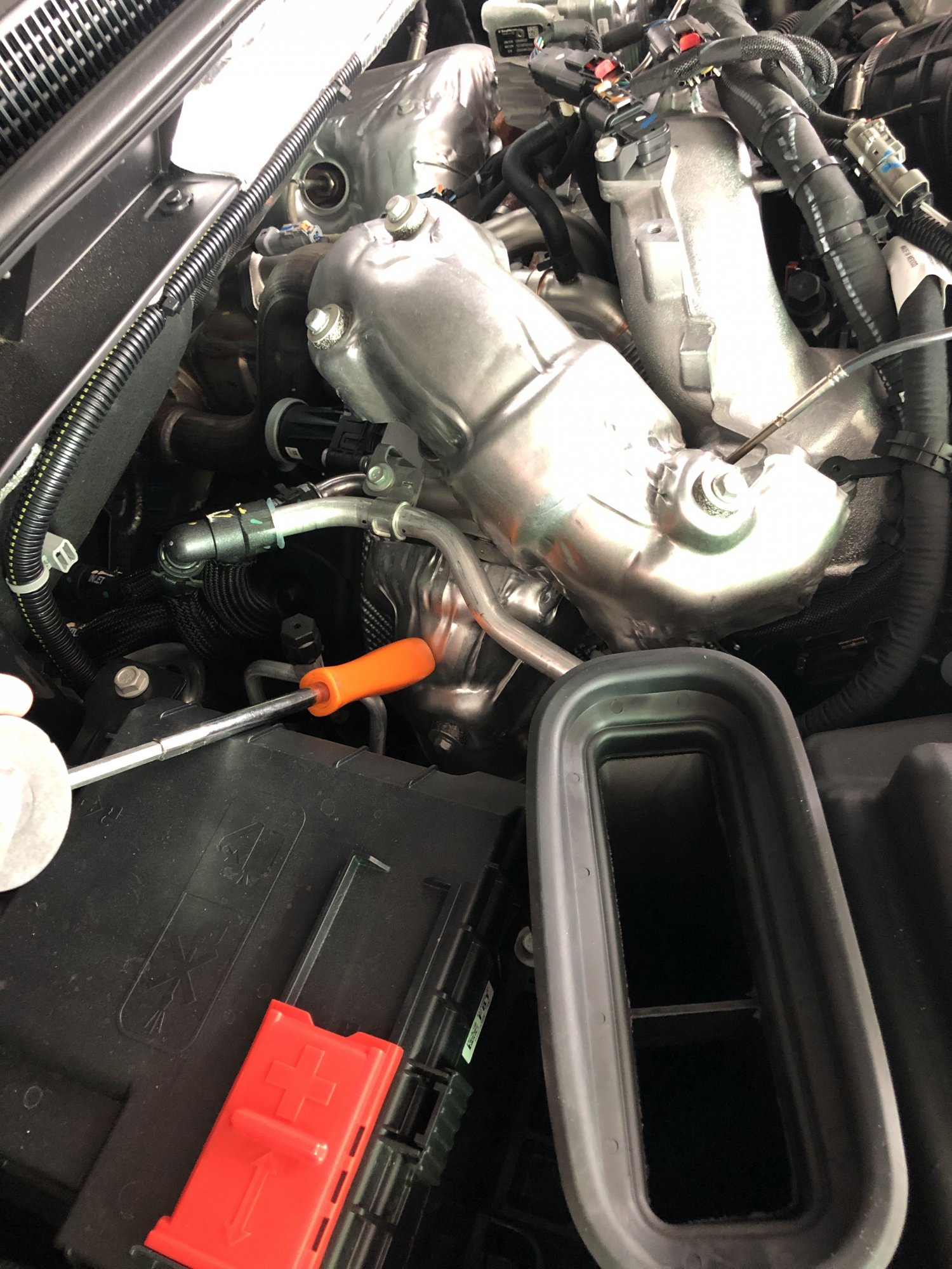

I spent a few minutes with my listening device (stethoscope) and found that the thumping was most pronounced and resonated where I am pointing with the orange handle in the 2 pictures. I do not know diesels well at all, but I believe this is all part of the turbo, right?  Good to note that I did not pick anything up at the bottom of the motor or on the tops of the valve covers. Thoughts?
1 minute ago, Tomato said:
This is the second area where the sound is most pronounced.  It is the back tube coming off the top of the motor.
well if that's true my assessment is if the sound comes from that far up on the engine it is a fuel injector and is likely normal.
