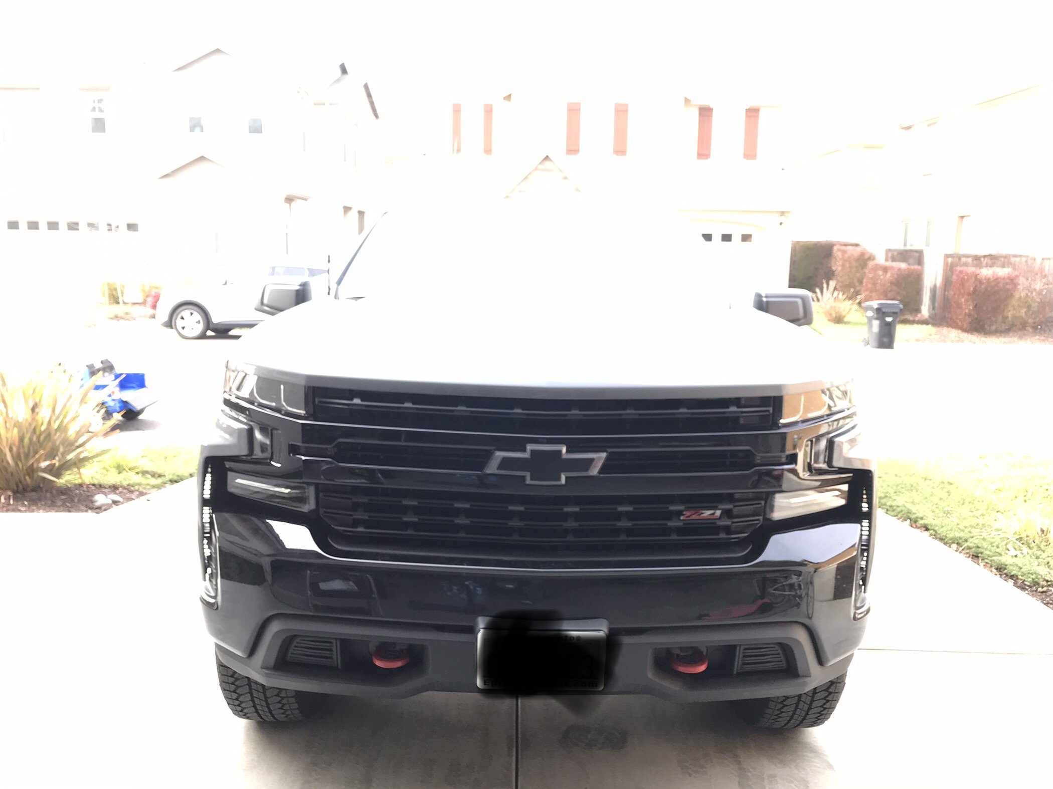

had some free time today so I installed the foglights and headlights. tomorrow I will try to finish it up. I need to clean up the wiring and put the rest of the body back together. I did not upgrade the grill yet so I'll need to figure out how to make the "custom" grill work temporarily. If I had more time I would have made a tutorial video because the only thing I could find on YouTube was how to remove the grill and another video of truck with no headlight but it did help. I only broke about three plastic clips lol

You will love these headlights.!! The resistors are mounted on the metal brace next to the headlight.  If you look you can barely see them when you look under the hood. The wire isn't super long for them so that was about the only place to put em.
My gm fog light kit plugs in just like the bowtie so you shouldn't have a problem. It plugs in between the passenger light and the harness.

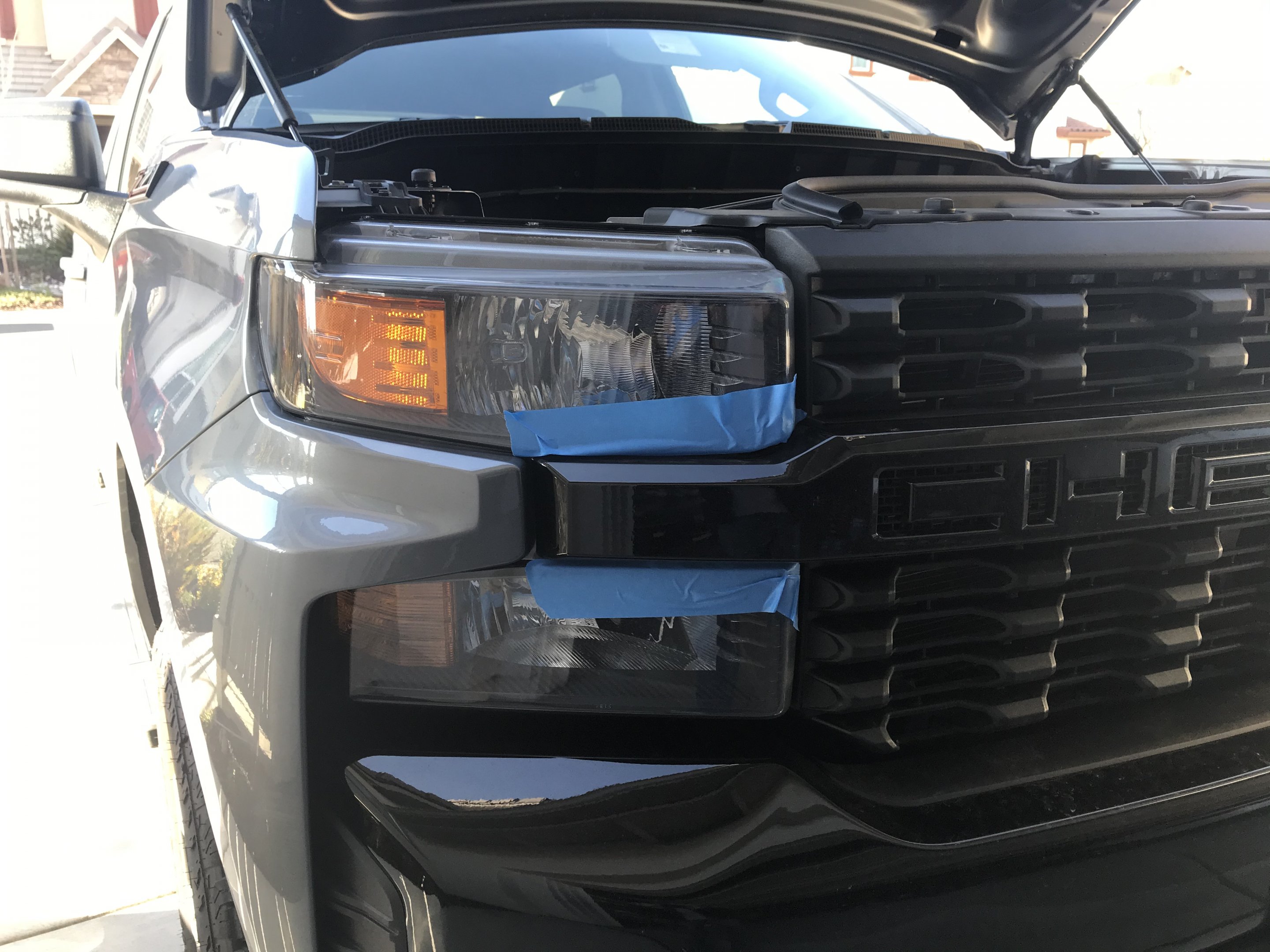

Thanks! Spent a few hours and was only able to get the grille and passenger headlight out. So far no broken parts lol.
Saw a couple videos on the web regarding headlight removal and your guys post were all extremely helpful. I didn't have to remove the panel filler on the sides of the front bumper since I was able to reach one of the headlight bolts using a ratcheting wrench. Next to the inner part of the headlights are gaskets that are secured to the front frame with Christmas tree rivets which need to be removed otherwise sliding out the light would be difficult. Will try and upload pictures of gasket. Ran out of time so it's back in the garage waiting for tomorrow morning when I can hopefully complete the front conversion.
