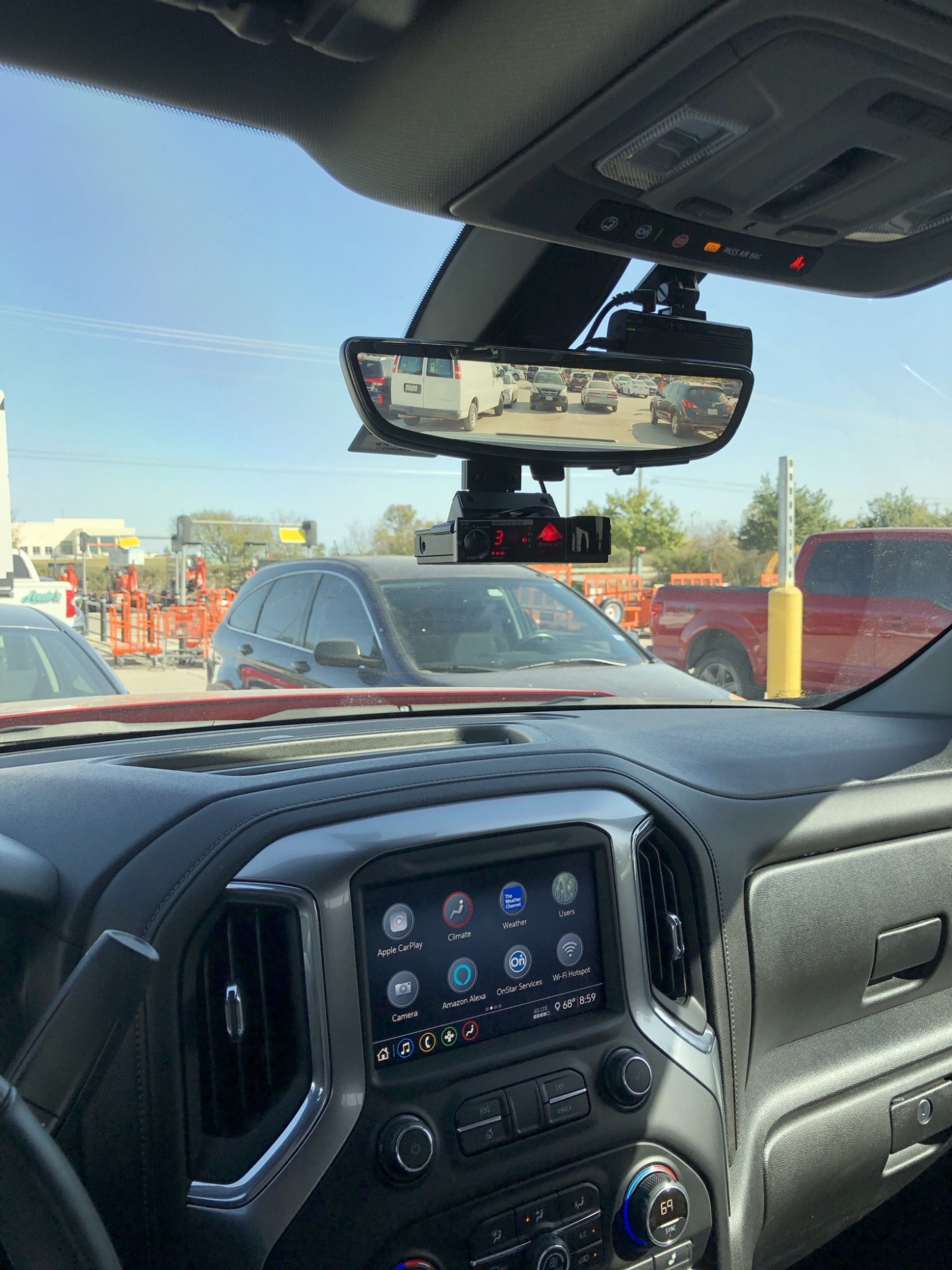

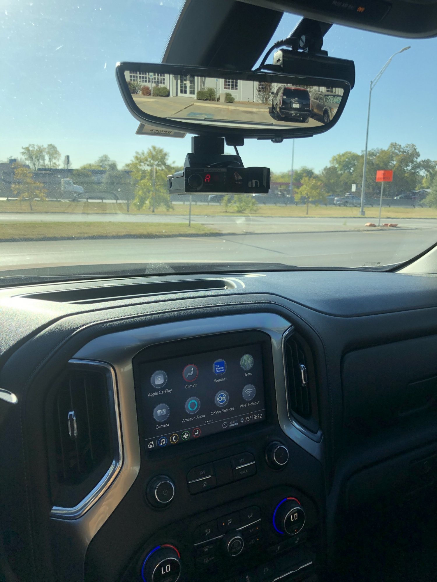

I was interested in this mod but it seems like you are replacing an actual mirror image with an image from a camera.  What is the advantage to have the camera to justify the mod?  Is it mainly for a wider range of view behind you using a camera?
Much wider angle, and the huge benefit of not having the window frames, headrests, and passengers blocking the view. You can also clearly see people in the cars behind you picking their noses at stop lights.

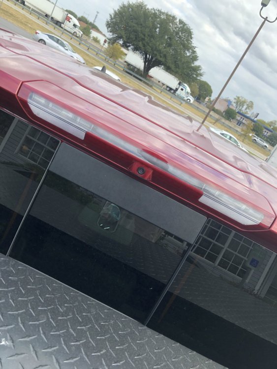

I did this install about 3 month ago.  Here's what I got:
P/N: 13536995 Mirror     (Ordered New from a GM Parts Website because the "take off" I got from eBay came DOD)
P/N: 84487008 High Mount Lamp   (Got the entire spoiler, lamp, camera, and harness from eBay but they now sell just the lamp, camera, and harness for a hundred bucks less )
P/N: 84335461 Cable   (Order from Amazon)
The only issue I had was removing the rear clips from the headliner.  I tore one of them by mistake.

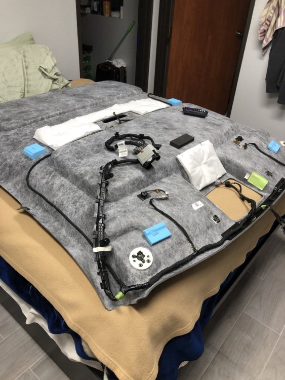

Sorry I've been busy recently and haven't been able to update y'all but I did finish in about a day, I did also do a Rolls Royce Starlight headliner so that added to the time it took me to do the mirror (because I didn't have the headliner harness in).
It isn't necessary to remove the whole headliner from the truck, however I did because I wanted to do the starlight headliner and sound deaden the roof with Killmat deadener.
I didn't have any problems, I was sure to glue the coax cable down to the headliner so it wouldn't rattle with music and also used some outdoor silicone on the bolts for the spoiler and the third brake light to reseal the cab and prevent any leaks.
Everything worked perfectly no misalignment or anything like that.
There wasn't really anyway to show you how to do it but there is a video somewhere in this forum from Infotainment.com that shows you the install, that kit is $1500 and I don't think its worth it just to have them in one box, just order them separate from gm parts suppliers, its way cheaper.
