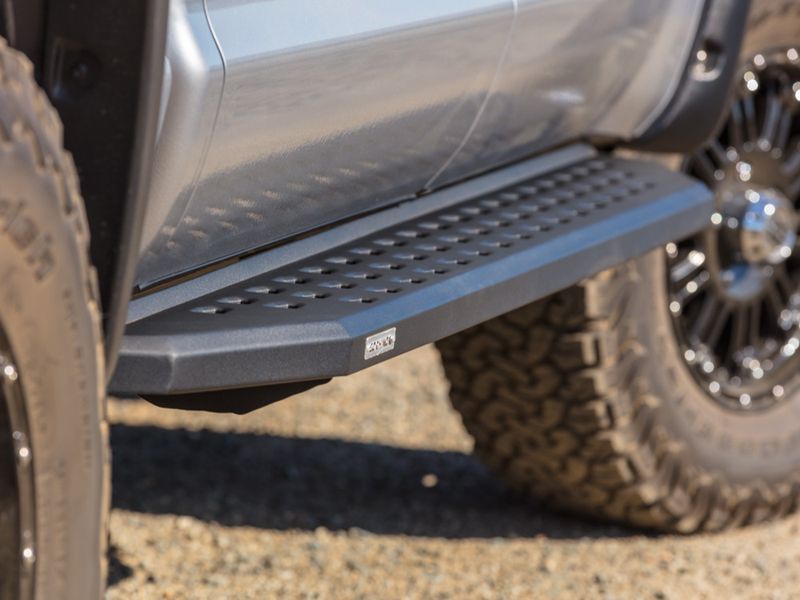

I purchased these
LINK: https://www.carid.com/2019-chevy-silverado-1500-running-boards/steelcraft-stx600-running-boards-1739239861.html?parentsubmodel[]=SUBMODEL|Crew+Cab
I enjoy them on my truck but they are heavy. Roughly 40lb each side
I was trying to get the Ionic 41 but could not find any to buy at the time.

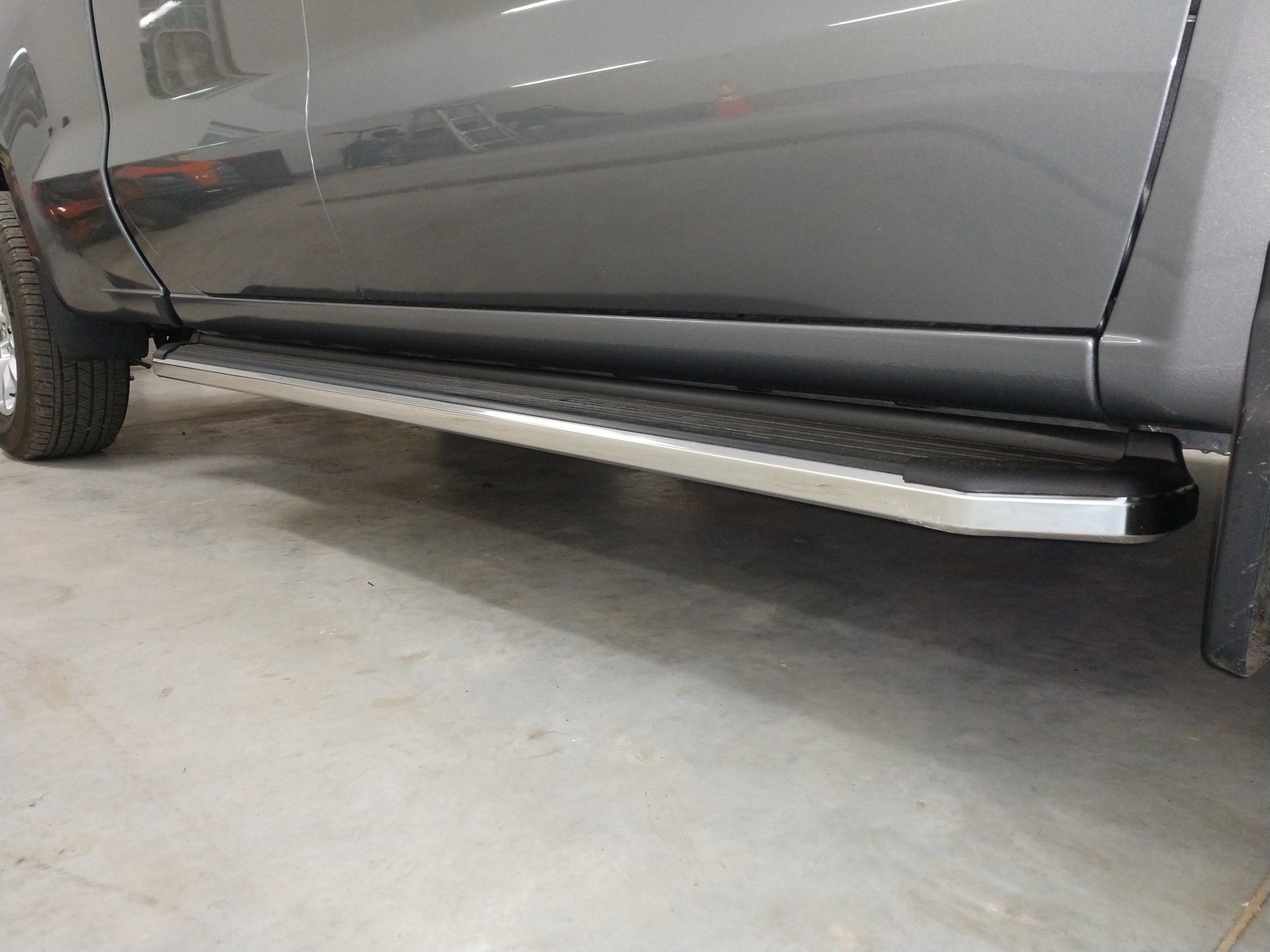

Do the ionic 41 stick out enough that it would protect the side from other people's car doors? Sounds silly but it's my main reason for wanting them. Yeah it will help the kids too but they don't ride with me very often. Also, how difficult was the install? Edit: Watched the install video, seems easy.
Edited by batman900
I think they're supposed to be 5 1/2 inches wide. I just stuck a 4 ft level up to them and the door is about an inch wider than the step at the body line. They visually are in line with the gm accessories mud flaps looking down the side. The installation was easy. Did it without a jack or lift. Pop out the plastic plugs in factory mount holes. Only thing I did differently than the install video was on the brackets. I only put the top bolt in loose before the step because they sit so close to the body that you won't be able to get the step in the bracket slots.
