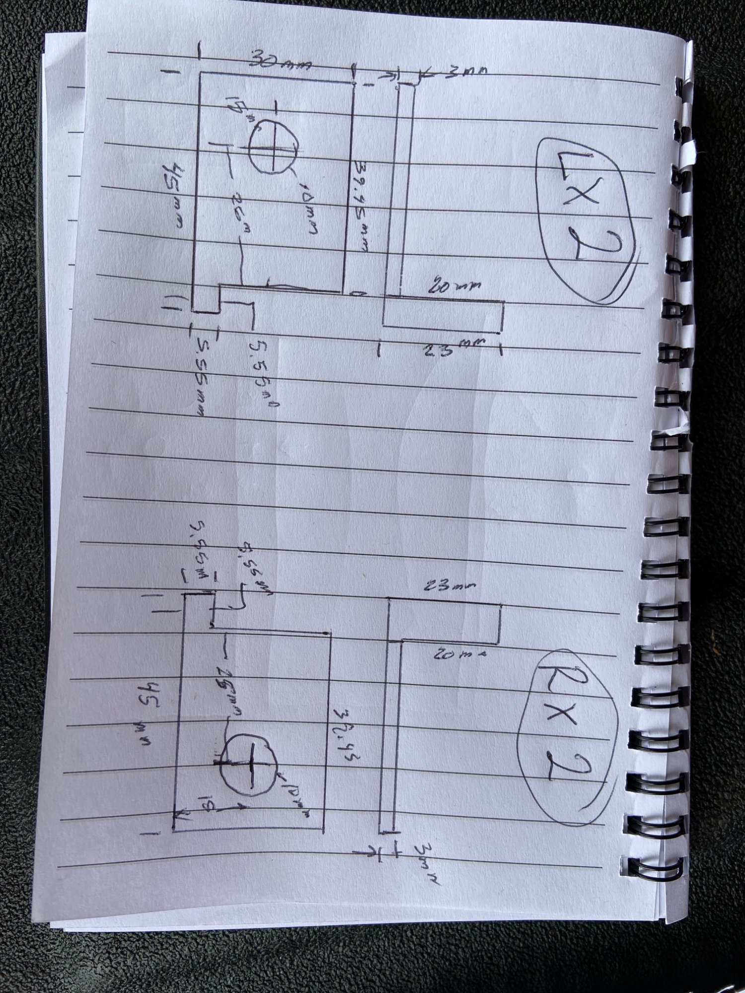

Thank you. I also have been considering a modification to the multipro 2nd tailgate hard stop. I tested it with some Allen keys stuck in both sides between the positive stops. It made the lower step come down shy of a few inches of normal position. I know the step is angled in this scenario slightly , but it still can be used, and it would clear a normal B&W Stow and go hitch so you don’t need to drop the extra $100 for the Multipro hitch which has very limited drop positions. Anyway, if someone were to make a bracket to fit where I placed the Allen keys, they could bolt on as there are bolts next to this location. Anyway just thought I would share this idea..
This is great! Did you ever make any brackets for this? I have a swing away hitch that I am hoping to clear when in the open position... and I think something like this may give me the added few inches I need. Do you have any pictures of your set up with the wrenches?
I didn’t make the brackets yet but I do plan on doing when I have some time. I don’t have any pictures of the Allen wrenches in place but it’s simple to do to see what size you can get away with.  I use my kill switch all the time now. Best mod I have done in a while. Just last week it save me at the lake as one of my boys was getting in the truck bed with hitch installed.
