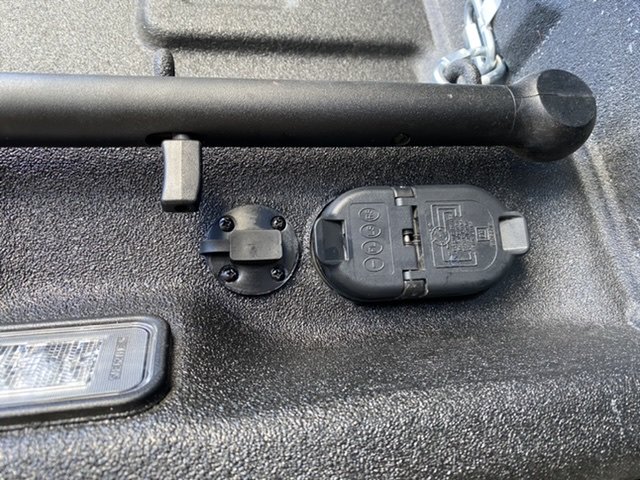

I have a 2020 Denali Duramax, I'm having issue,  when truck is off, the trailer lights stay on, first time I connected the trailer it drained my battery, then i noticed I get a pulsation on the trailer break lights.  does anyone know if this is a know issue?  Or do I have to disconnect the trailer ever time I turn off the truck?
1 hour ago, Garett Dixon said:
I am having the same issue with my 2020 GMC AT4. I have LED lights on my boat trailer and they are not working correctly. I had no issues with my ram 3500. Did the dealership find a way to make yours work?
So I got it into the dealership a while back and they replaced the trailer light control module and it still didn’t fix anything. After that they were able to steal a receptacle off of another truck and swap it onto mine and establish that it was just a faulty receptacle. It’s worked perfectly since they replaced that.

I have a brand new 2020 Chevy 3500. Bed plug works fine on my 2006 Platinum LQ trailer with EOH brakes.
Tried to use my 2014 Sundowner bumper pull and the Park Lamps (running lights) and Trailer Brakes won’t work. The rest of the lights and signals work fine. At times the truck will not even recognize the that the trailer is connected.
All fuses in truck are fine, replaced trailer plug and same thing. Hook trailer to my 2017 F-350 and everything is fine.
