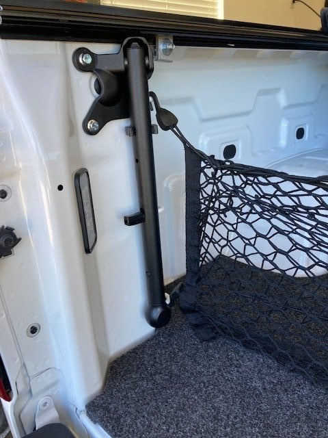

I just noticed the "Bracket" as the part intended to mount the Assist Handle.  On my 2020 Silverado Custom, I took a different approach  by installing 8mm Nutserts in the two rearmost mounting holes rather than using the "Bracket."  So my handle is mounted using 3 8mm bolts.  The mounted handle is very solid using this approach so I can't see changing anything at this point.
