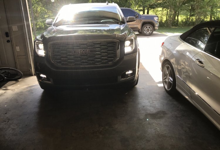

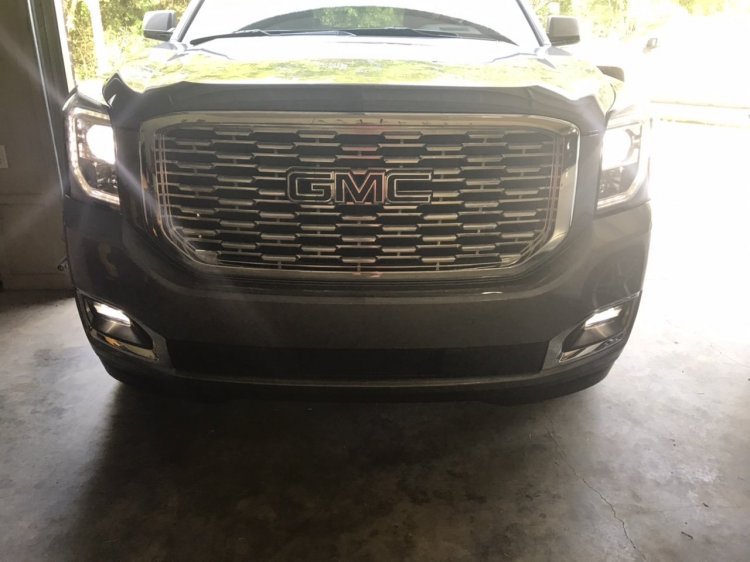

You're not crazy as they also fell short of my expectations. Though it's a great upgrade and would do it again, I was hoping the unit would project the light out with cutoff on top only (such as projector normally do) yet shine a sliver as ppthere's a bottom cutoff which would be useful to illuminate the road lower/closer to the front of Yukon.   Regardless, total output and lighting is more than stock and worthwhile to do.
Here are pics, first of just Morimoto LED fogs and 2nd with stock lows on garage then fogs only on road.
