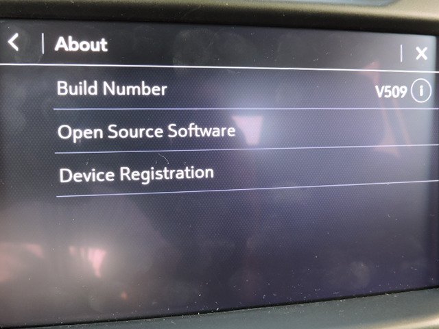

My IOS radio came without the Nav and dealer upgraded with the software and SD map card kit. I previously had an 800 version of software, I forget the exact # and after the install it is running on ver 509.1 with the Nav system fully functional. I questioned the installation of an earlier version of the software with the Nav and the mechanic said when he registered the software with GM and gave them my VIN he was told that the older version was the most compatible with the Nav and all the other optional accessories and modules installed in my particular model and VIN. A check through the DIC confirmed I had the latest version. Not only does everything work 100% with the older version, but the Climate Off bug is now gone. No way I am going to manually update the system and turned the function off to make sure it doesn't try to update itself.

I'm still on 509. Took it to the dealer and asked to check it and update it. They told me there are no updates for my radio. I think that's BS
But it still says No Updates Available when I select Check for Updates...
Why? 509 works all the time! If it ain't broke, don't fix it.
Everything works 100% of the time using 509, including the Nav with no glitches or weird crap.....even the "Climate Off" bug disappeared after the Nav was installed and GM directed the tech to revert from the original v805 to v509. Mine also shows no updates available and turned off auto update anyway.........it's not like the newest rev will add a magical new feature....update is only useful to correct and existing problem....and none exists, so no update needed. Drastically different from the current 800 series perhaps the lower number 509 is not really a lower rev but a default version of a known stable state before they started screwing with the code, each successive one introducing more bugs into the system.
