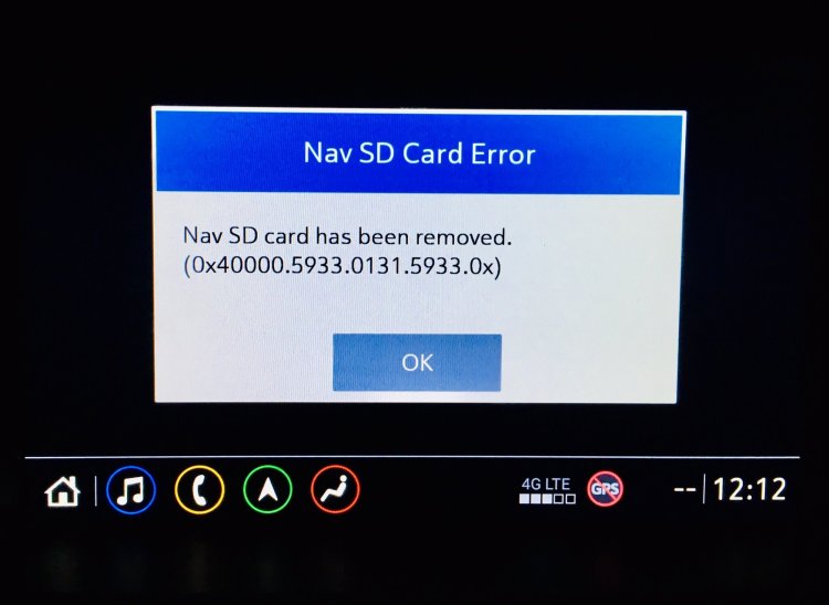

Hi everyone,
Long time; hope all is well.
2019 Chevrolet Colorado ZR2 here.
Truck was calling for a software update, so I updated to V805.1.
Unfortunately, I’m now receiving a SD Card Error each time I try to use the navigation system.
Pretty frustrating. Can someone please help.
Thank you very much.

oh god please dont tell me this is the same problem i have in my 2017 CTS-V if this is the case the problem started with IOS 13.x the nav locks up and the system reboots.
try this, turn off your bluetooth on your i-phone see if it boots up ok. then try turning bluetooth on. take a quick drive. if its the same issue we cadillac owners are having then i highly recommend nobody do this upgrade until i fix is out! the only way i can use my system in the caddy is over the USB connection and carplay. otherwise the systrem reboots and goes bonkers. also my caddy display looks just like that, the temp reading goes to - - and sometimes it reads in C verses F
