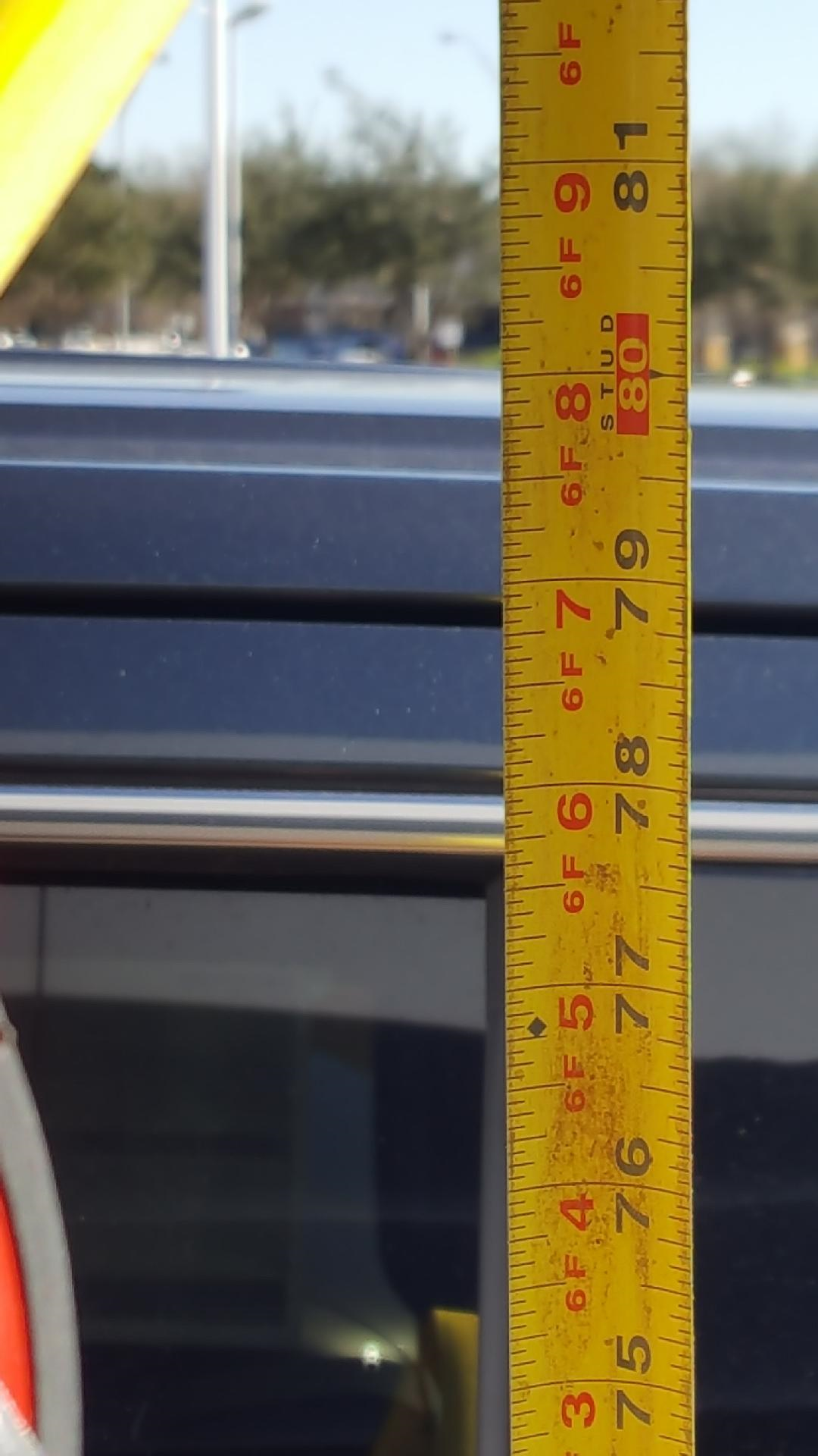

Just for your reference. The shark fin is not the highest point on these trucks. There are 2 extruded ridges on the roof that are just behind where the sunroof is. The highest point on those ridges is the tallest hard part on the truck. On my 2500 with 20” wheels, that part was about 80.125”. The standard radio antenna is about 0.75” taller than that. The clearance bar for the parking garage at work is 80” and I was barely contacting it. I put som john c garage 1.4” drop shackles in the rear and I now just barely squeak under that bar. Like .125” under. If I don’t have at least a half tank of gas I will barely touch on the passenger side. The garage is actually around 6’11” inside so I’m good.
i think you’ll be fine, but your best bet is to test drive one home and check it.
