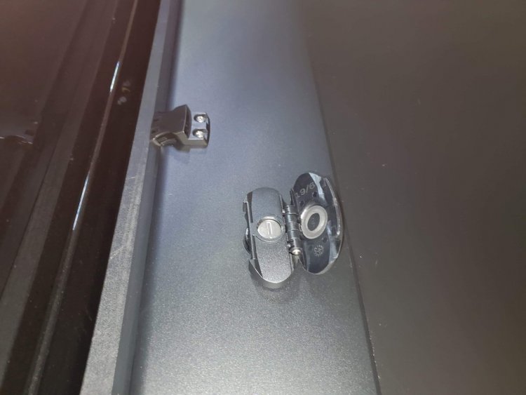

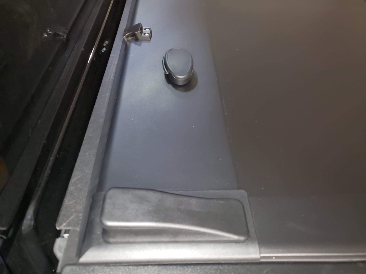

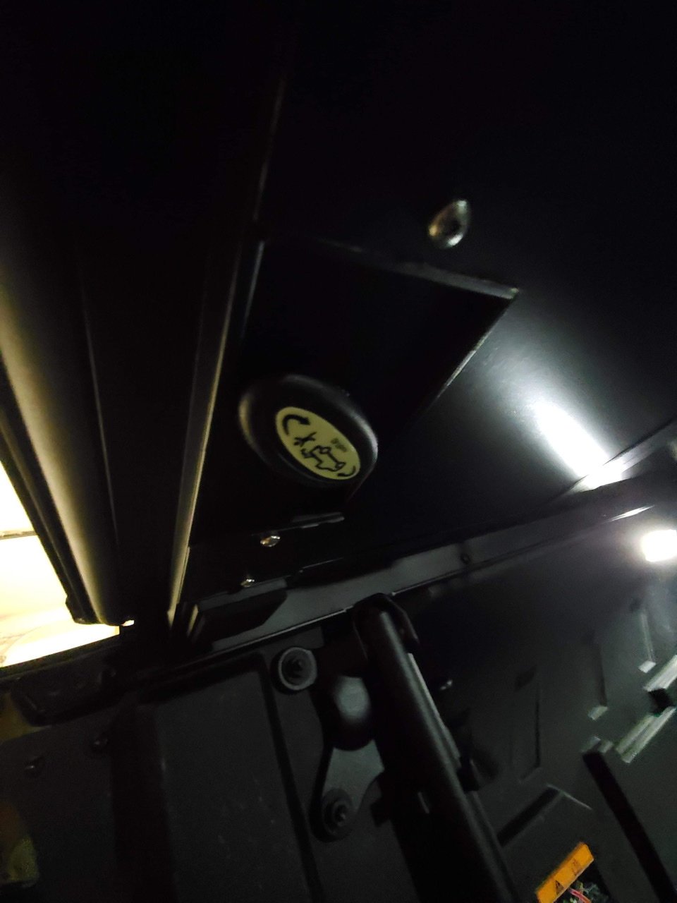

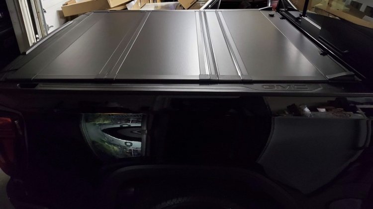

Ok all installed. Took me maybe an hour. It’s all about the “J Hooks”...that plastic cap on top of the sides of the bed hides some pre drilled holes in the composite underneath. I used a pry bar to pry the plastic up and slide the j hooks into the square holes. That’s the hardest part really...after that just screw in some screws and put the cover on. There’s a couple clamps (you can see one in the pictures) that hold the whole thing in place that mounts into a pre drilled hole in the rail. There’s a nice lock on the cover right up against the cab and the other end opens with a twist handle (you can see it in the pictures). The tailgate opens freely and overall I think its a great tonneau cover...it’s made of a Super heavy duty material and it’s a nice low profile tonneau. Good job GM!
No...when you get eye level just lift up and you will see the square hole (it’s offset...not straight). Next to every square hole is a slightly smaller circle hole ( it sits up a bit higher so pull that plastic cap up more to see it). You slide the J hook into the square cutout and snap/slide it in, by doing this the nut portion of the Jhook/nut will sit behind that smaller circle hole...and that’s where the screw goes through. Once you see how it works it’s easy to do...just took me a few minutes to figure it out.
No it doesn’t...it folds back upon itself twice. That third fold doesn’t move. So essentially if you need the entire bed for something large...you’d have to pull the cover off. I’ve been using an extang solid fold for the past ten years and it works the same way so I’m used to it. But if you always have large things in the back of the truck then this might be more of a hassle...but again...for the couple times a year I need my full bed...I’ll just pull it off.
