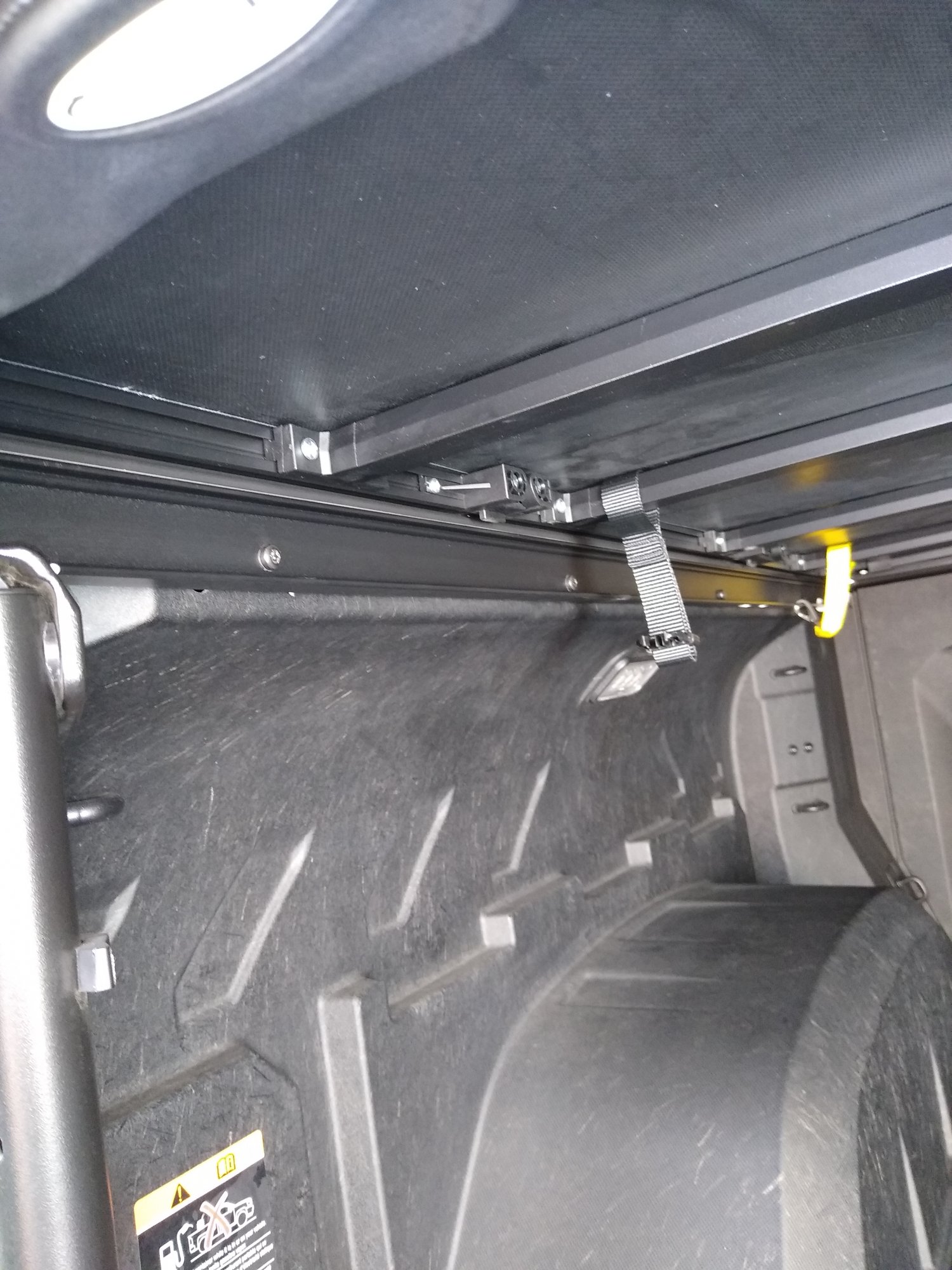

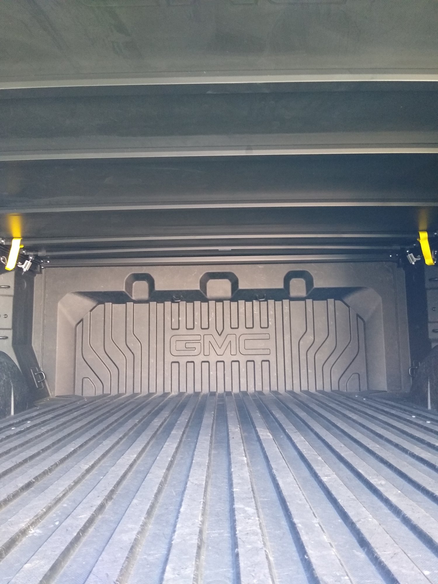

I placed a Retrax pro off of my 2019 Silverado onto my new 2021 Carbon Pro Denali 1500 Duramax.  It took a little time to come up with a way to secure it, but for about $25 and time it looks like it did on my traditional bed.  I would insert pictures, but have no idea how.

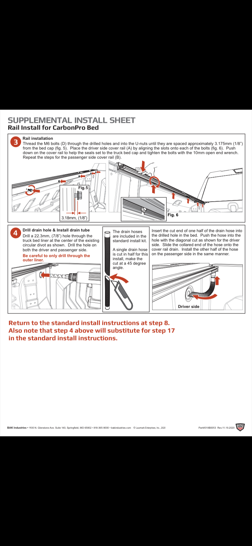

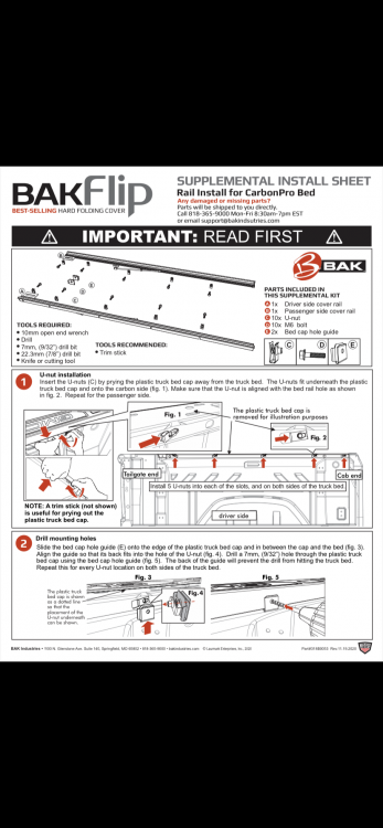

I asked Bakflip what modifications they made to make it work with the carbon bed. They sent me the install sheets. I would have bought one by now but I can’t actually find one here in Canada. Some sites say they have them in stock, but they don’t,  I’ve spoken with a bunch of retailers and they have no idea when it will actually be available here.
