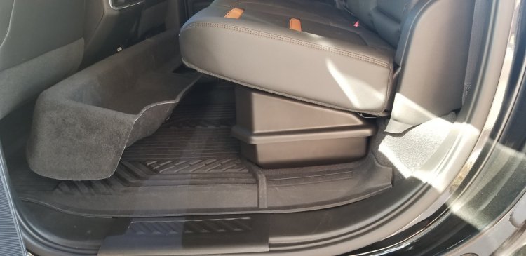

Sub is installed and sounds pretty good. Haven't put it to the test yet, still breaking in. As for the location, the sub is now in the center of the cab. Which is nice but now stretches into the driver side. It does leave a little pocket but I fear it'll cause some rattling.
do you have the Bose system? if so how much do you think it added to the bass? did it extend the low range? or just make all of it louder?
I do have the Bose with the "7th" speaker/sub.  I wouldn't say it made it any louder but it definitely beefed up the lows.  It's not a JL sub system but it definitely does the trick for a single 10.

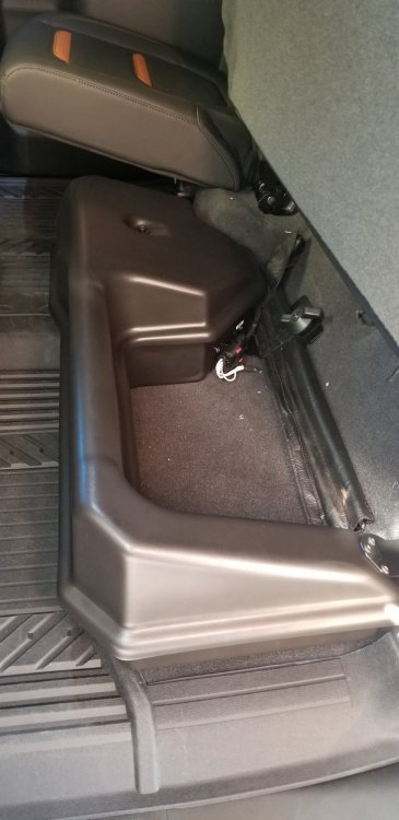

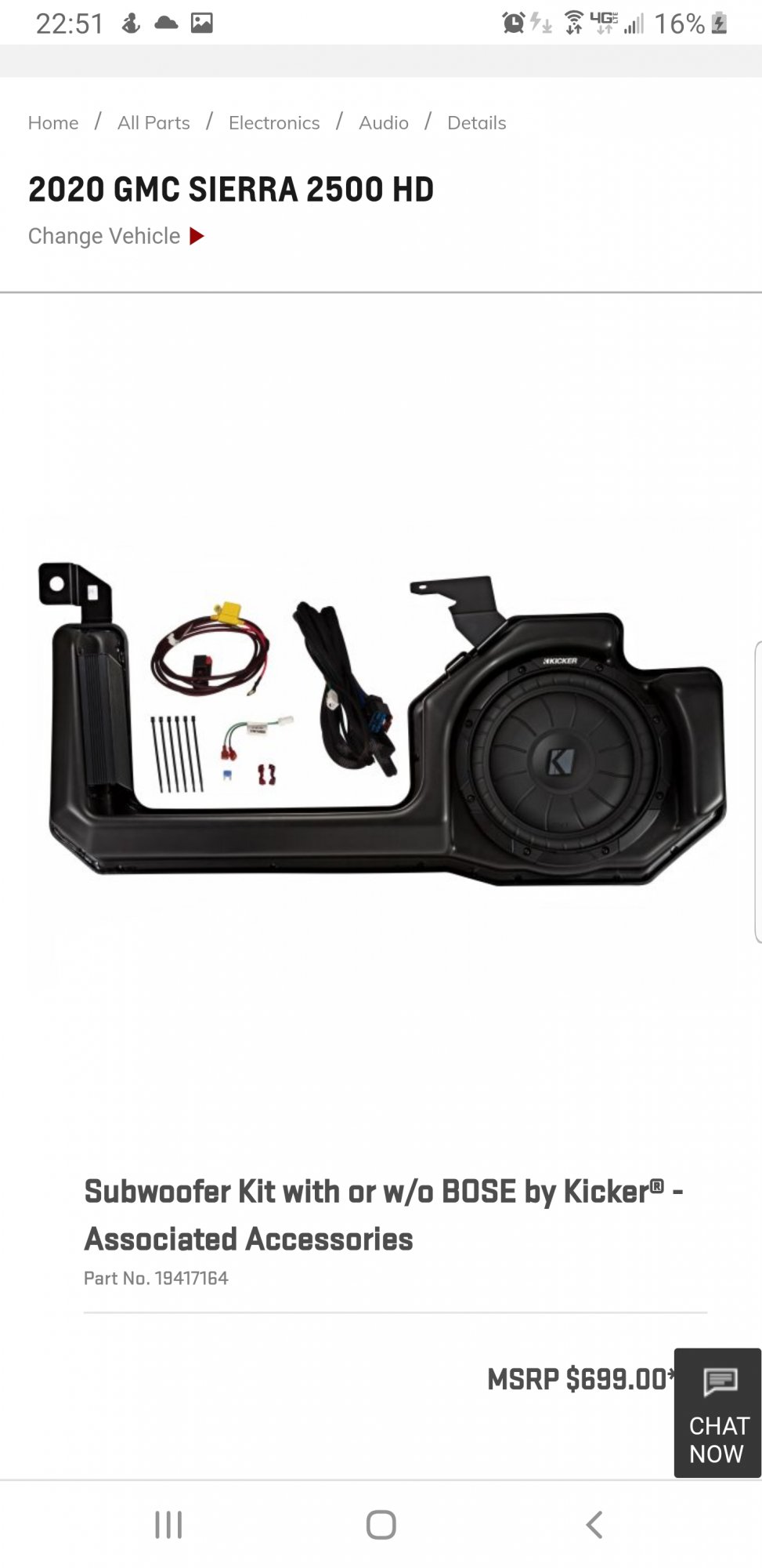

Factory option Kicker Subwoofer for under rear seat,  Beware !!  TWO versions.  Early ones had the capability of adding a Remote Bass Volume Control, with a 17ft. cable.  Chip shortage, forced a re-design, and eliminated this !!  I spoke to Tech's at Kicker confirming this.
They said the early design with Remote Bass Control will resume production "Soon".  ???
Way to tell, is the Amp if capable, has a Rectangular White multi pin Female receptacle, flush with one end, and case is square. Next to that White Recpt. will be a Female 1/8" Din port, to add the remote.
Ones Without Remote Bass, is a Rounded Corner Amp Box, and the main power & speaker connection, is on a short "Whip cable", with a Black Rect. Recpt. Plug. NO Bass Remote !!
I wound up doing a quick add on Kicker 46HS10 "Hide Away" 10"  180 Watt internal amp unit for $370 from Crutchfield. Will fit just about anywhere, and included the Remote Bass Control & Cable.
