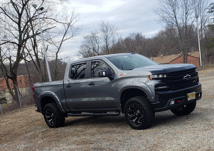

I have seen a lot of level kits and 6" lifts in the forum but haven't seen any T1's with the ReadyLIFT 4" SST yet so here's my RST.  :)
I wanted to fit 35" on my T1 but didn't want as much empty space above the tires that a 6" lift has.  I read good things about the SST kit in terms of quality which is there, and being a much simpler install that can be reverted back to stock is a plus too.  Given that the front diff is narrower and the front axles are much longer than on 18 and below models, this 4" kit should do the trick with It's upper control arms to correct the geometry.
Although there wasn't supposed to be any rubbing it was slight but it was there in the front.  In the back of the wheel well, I just removed the bracket behind the mud flap and I've got about an inch of clearance now.  On the front of the front wheel well it very slightly came into contact with the felt liner.  I just drilled a small hole in the liner where it made contact and used zip ties to pull it forward.  Lots of extra room now without any trimming at all.
Also, the space between the back of the wheels and the brake caliper rib there is almost an inch of space.
This it what I've installed so far:
1. ReadyLIFT 4" SST lift kit
2. Fuel Vandal 20x9+1
3. Nitto Ridge Grapplers  35.12 x 11.77  (295/65R20)
4. Gatortrax retractable tonneau
5. OEM Wheelhouse liners
6. Removed "Silverado" from fender and added Black and Chrome Z71
7. Installed quality Stubby antenna
I think I'm part of a small group of people here that drives on a dirt road daily so the truck insn't clean in the pics.

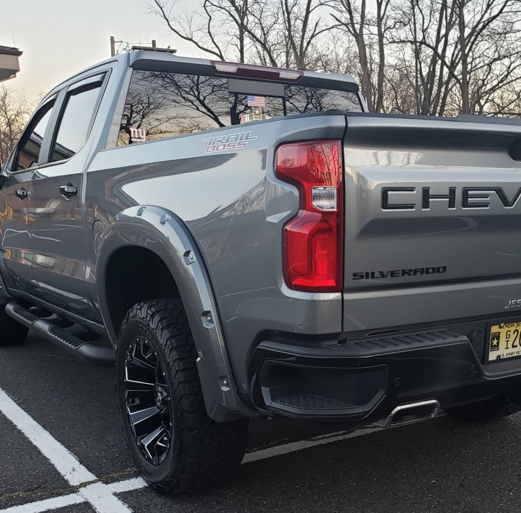

2019 Trail Boss with Ready Lift 2" SST Lift Kit (4" total)
SCA Fender Flares
Fuel Assault Rims 20X10 -18
BF Goodrich KO2 305/55/20 (33.21")
No Rub Want 35's
Eye Catcher Tailgate Insert Letters
Blacked out letters

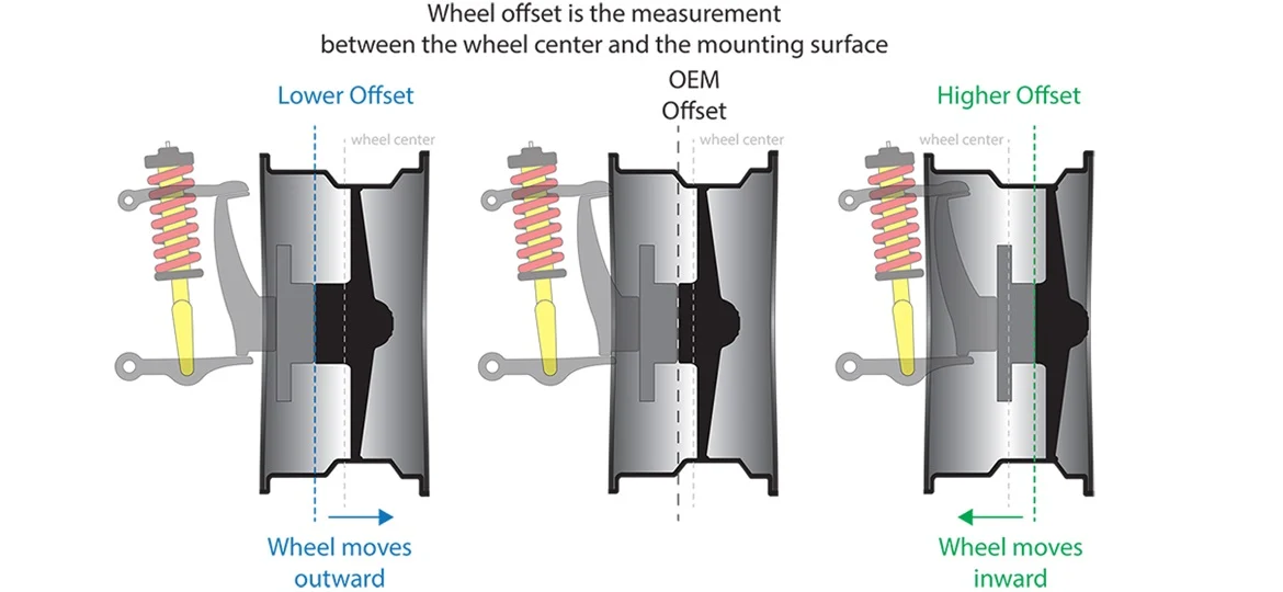

I now have Method NV 18" x 9" wheels with 18/5.75" (offset/spacing) -  (part number MR30589060518) - so this photo is not with stock 18" wheels - but there is about 3/4" of space left - so that is the room left to play with.  Offset at 18MM for my Methods is 8MM less than stock 18's (26mm) - so at 0.7" vs 1.02" stock (positive offset) - that would suggest my Method wheel puts the tire 0.3" further from the the UCA.  Looks like stock 18"s are 26MM offset and stock 20's are 28MM offset (not sure about either, but what I found on net).
Ready Lift sight shows for kit - you can fit - AT4 - Max tire 305/55-20, 20x9 0 offset wheel- the zero offset should move the tire 1.1" further out from UCA than a stock 20" if my math is right so that would give you less room to play with a stock 20" wheel over a zero offset wheel - if a 305 is 12" across and a 275 is 11 inches across they would have the same clearance to the UCA on a zero offset and stock offste (28MM) 20" wheel.
Lot of factors in play - with a stock 20" I tihnk you will be limited to tires that are 275-285 in width (11" section width).  If you go on tire rack and look up tire by size you are interested in, they will have a spec option tab you can click on where you can see the diameter, width etc.   Here are widths for K02 and Duratrak
                                                            Goodyear
For Example:              K02                    Duratrak
275/65/20                10.9"                   11"
285/65/20              11.5"                   11.5"
305/55/20              12.4"                   12.4"
Since I have about 3/4" of space from my tire to my UCA with 18mm of offset - I could go up from 275 @ 11" Duratrak or K02 to a 285 at 11.5" and still have 1/4" of space to UCA with my Methods - with my stock wheels I would be about 0.30" closer - so about 1/2" of space - so going to 285's would put the tires very close to the UCA's.  So all about the offset of the wheel or adding a spacer to move the wheel out, to give more room for a bigger tire.  Then you have to shift your focus to overall diameter, to see about rubbing of the larger tire - and what you will havt to trim, if anyting.
