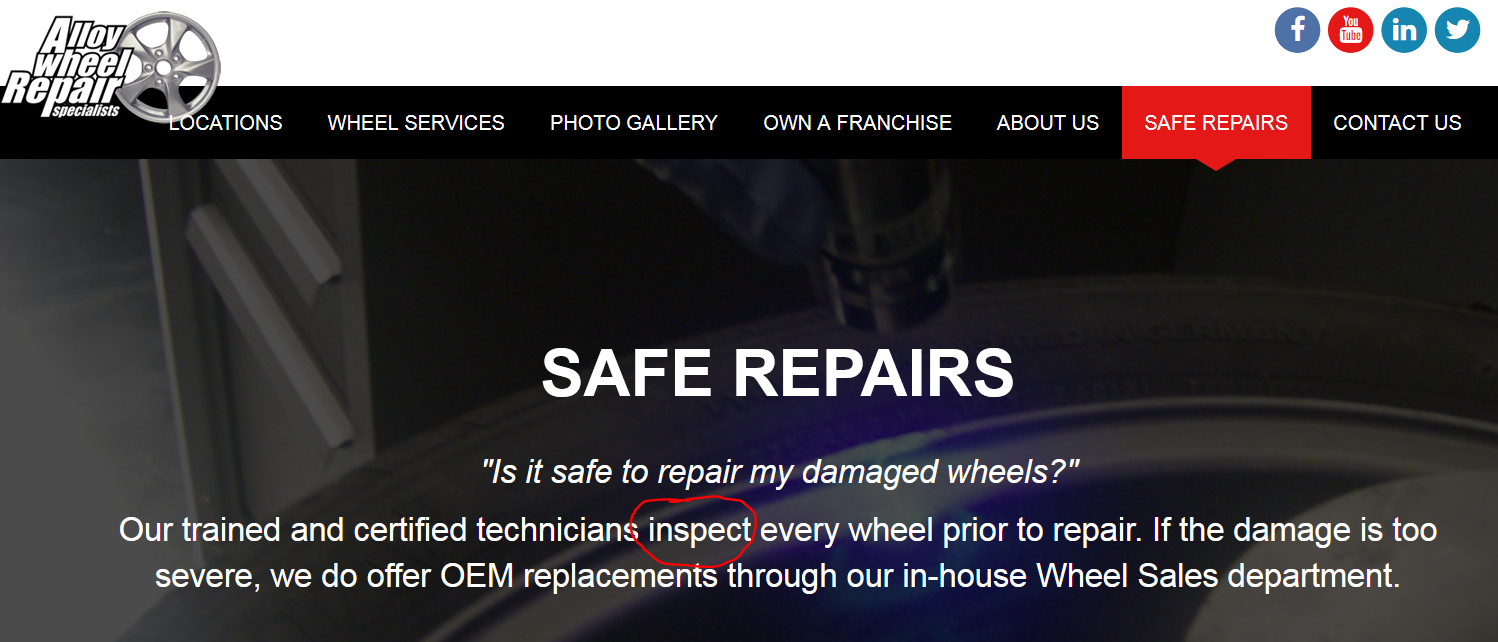

Wheelguy Posted September 15, 2019 Share Posted September 15, 2019 (edited) 5 hours ago, Grumpy Bear said: Well thought out prose and made me take a step back and thinks. So I did some investigation. I certainly have no wish to be riding around on bad rims. Forget the women children and pets....I ride in that thing!!! https://www.awrswheelrepair.com/safe-repairs Checked with my shop and these are the guys he used for the repairs. ALL of your/my concerns should be laid to rest. Every wheel is tested before repair, then reheat treated and tested again. If it doesn't pass at any stage it is scrapped. Safety out of the way, any wheel that doesn't run true can be made so and now we are back to the initial issue of band-aiding defective tires. I will stand pat. A tire that requires a road force balance is defective and unsafe. You also got me thinking about the economics of it all. It came to me while eating a hamburger. The answer isn't in a companies ability to force feed you a defective burger. It's in yours not to accept it. You might not win your individual case but when a company gets a reputation for a bad thing, bad things happen to that company. I.E. People by their burger elsewhere. Not all tire companies make junk. Reputable manufactures will have little trouble resolving your issues. It's the discount house middle man and low volume discount manufactures that have the most issues. I had a Mikey D Big Mac yesterday. Haven't had one in decades. Certainly isn't the burger it was when I watched Mickey open it's first store in Cedar Rapids Iowa. I will never EVER eat one again. I can go to the local tavern and buy a very good burger and fixings for the same money and get it quicker too. (is there anything slower than Mickey D's drive trough?) Point is, that burger will live forever. It has a following. Just not mine and because it is still here doesn't make it my only choice. More than likely, you're riding around on safe rims - but that really would depend on the repair and the location that was repaired & the extent of the original damage. My main point isn't really aimed at your particular case - but in general wheel repair of any kind without regard for severity or what's being done to repair it. So I follow that link you posted & read the top...it states they inspect, not test, prior to repair. Why does it matter? A test implies to me they put it on a machine and performed some sort of fatigue test (not called fatigue inspection) or important validation. Inspect could be something as simple as a visual inspection. So I am happy to see they are at least looking at the wheel that's intended to be repaired but certainly not doing any tests of real value (proving the repair doesn't fail). This inspection part really doesn't matter much - splitting hairs again, but just showing you that the claim is pretty much what a customer would hope is just common sense on their part. So move on down that page & watch their video. Starts out by stating more than 80% of repairs involve "road rash to the flange, scratching of the spoke or clearcoat degradation" or in other words things that are cosmetic defects and are a far cry from being structural defects - two different things & very important to note. Then they go on to demonstrate how well they can cosmetically repair a wheel by setting up an experiment deemed "more severe than AWRS would attempt to repair" and go on to cut a 2mm deep groove through the design face side. So they're telling ME they wouldn't touch any wheel with 2mm or MORE of any damage. OK so why do they have before/after pics showing deformations that to me are obviously exceeding more than 2mm? Hmmmm - so then why are these being repaired then (Click Photos at the top then click on Wheel Straightening to the left of the images): For now, ignore the arrows in the center of the wheel & focus on the one in left image, the upper left center portion - that's the deformed area they repaired that according to their video is less than 2mm (because 2mm exceeded their limits of repair, remember). Ummmm, no - that's at least a half an inch (12.7mm) and I'm being VERY generous by giving them that - it's more like 3/4 to an inch. Ok - so they fixed it and the result is on the right image. But wait....why are the spokes in the left image going in one direction and the those in the right image going in the OPPOSITE direction (arrows in center can now be referenced)??? Uh oh, these may not be the same wheel - they're directional & they're not even showing the same wheel. Shady? I don't know - probably just a screw up but doesn't help them any IMO. Is there something to hide? No clue - only thing I know is they said 2mm exceeded their acceptable repair threshold and that's obviously not completely true or they're doing a poor job of demonstrating 2 different capabilities, cosmetic repair & structural repair. I don't care for a company to go to these lengths to explain what they do & have a question like this come up. Just me though - I don't trust wheel repair places for what I feel are very good reasons - and this just raises flags. It might be nothing though - who knows? Only they do & I doubt they're going to be very transparent about it. Next, let's dive into that groove they carved into 5 spokes all the way around the wheel 2mm deep. Just to not get out of hand even more, we're going to limit OEM talk to GM wheels - I know their specs better than others & there probably isn't a huge difference between the big 3. GM requires fatigue testing (the rotary, radial & impact tests shown in their video - there's that word test, not inspection ) to be done with wheels at low limit dimensions. Low limit is usually 0.4mm smaller (less, thinner) on ONE side or 0.8mm brake to curb (TWO sides) ALL OVER the wheel. In other words, it's not just a groove cut deeper on the face the whole wheel has been weakened. So, what they've done is cut a GROOVE (one small area) that is a bit over 2x deeper than what GM requires for typical fatigue testing (new wheel design validation). OK - not bad. Here's what they're not telling you. The area THEY determined to be vital for structural integrity is the WORST area they could pick for 2 of the 3 tests they did. That area will really only be affected by the impact fatigue test - the flange & the face side of the spokes. The other 2 tests usually have failures occurring on the BACK of the wheels (around weight reduction pockets in rear of spokes & areas on back of wheel where spokes meet the rim). Had they really wanted to impress a person with knowledge of wheel fatigue & failure, they'd have cut that groove on the back side & made it a bit deeper & much wider then repaired & ran their fatigue tests. That doesn't even mean the wheel would have failed, either. OEM wheel validation is done on a design by design basis, meaning each wheel with a different design has to be validated (actually it's every wheel mold but that really doesn't matter). But that experiment would have definitely been more severe than what they did in the video. Also, how did they grind it down so evenly all over & not have an obvious low spot? Probably recut the face (reface) and called it a day. 2mm is an a$$load to grind & blend out evenly (you'd have seen it in the reflections if it were ground down). Finally, let's look at that spec - SAE J2530. The AWRS says all repaired wheels meet or exceed the OEM spec: If you click the bottom red link, you see that they tested 7 bent rims that had been straightened & all passed. Great. Here's the problem though, SAE spec is only a MINIMUM spec that OEM has to pass - OEM is actually required to pass a much more rigid internal spec that isn't available to anyone who isn't a supplier to GM. In other words, by passing the internal spec, they automatically pass SAE because SAE isn't as harsh. So I'm not really sure where the "wheels tested to OEM standards" part comes from - it's true, but only in part (half the story for the 2nd time from them). They're not exceeding anything of GMs test requirements by any stretch of the imagination - only on rotary fatigue are they even meeting it. They're falling short on radial fatigue by 10x. Impact is impact - weight & height. Hard to skew the test to show in your favor with a one & done test I didn't read anything on their site about every repaired wheel being tested - I think what they're showing is their repair process has been tested on a sample size of wheels & they didn't fail. More like a process validation. But can you validate a repair process for each & every design, regardless of where the repaired damage occurs? Doubtful. If you repair an area that doesn't tend to fail the fatigue test, it's likely going to pass - but what if the repair is in those high-risk areas (edges of weight reduction pockets on back of spokes or in the rim/spoke union area)? It's probably going to fail or at the very least is going to increase the odds. Reheat treatment? Hmmm. That's a new one to me unless they call heat treatment holding a weld torch in a specific area and then cooling it. Fair enough but not what I would call an exact or proven process. Heat treatment is a very controlled process & the quenching temps are vital for a successful heat treatment. Now, if they're heating the ENTIRE wheel and cooling it - forget it. No way is that safe as the OTHER non-damaged areas would become more brittle and lose their original mechanical properties. Not going to get into that because it would require too much speculation on my part. I also didn't see the subject covered on their site but I didn't dig too far into that subject matter. It was simply something you mentioned above & I'm not really trying to turn this into tit for tat either; maybe your contact told you that? I dunno. Keep in mind, I am NOT disputing MINOR straightening (what I assume you had done) but these bends on rims, which go beyond the bead seat areas?? Not safe by a long shot. The picture below shows 2 things - a bend AND surface fracturing (area inside the rectangle has been moved/compressed past the aluminum's elasticity - it's reached its yield point & has fractured). The bend can be removed & the SURFACE ground & puttied & smoothed & polished but the INTERNAL structure has been compromised, regardless of what it looks like when it's all shined up & pretty. But is it safe? In this particular example, probably yes, because it's on an area of the wheel that's not really load bearing. However, we're talking wheel repair here - if that was in between the inner & outer bead seats on the rim area? Absolutely not safe - load bearing. On the back or front of spokes? Absolutely not. Radial & rotary fatigue will eventually open those areas up. Like I've said, I'm not saying ALL repair is bad - but I'm not going to say nothing when I see some potential half-truths & smoke & mirrors when I see it (not by you, but by the repair service site). If the above doesn't tell you something & what I said was standard scrapping practice by a globally known wheel maker in the racing, aftermarket & OEM segments doesn't speak volumes (and they were tight-a$$es - scrapping wasn't looked at as a good thing) then I'm not sure what else I can say will. Also, consider we're talking wheel repair - I've seen weld up repairs, etc. & am referring to really bad damage - not just the truing up of things. Maybe this particular company is better at sorting these out & not even considering them - I just can't say for sure & they aren't saying either. I'm fine with agreeing to disagree but there are videos out there of other repairers taking a wheel that should be scrapped and reforming it using hydraulic presses with arms to isolate the pushing & pulling. Not what I'd consider straightening or minor repair by a long shot. Sorry if some of this is repetitive, long posts are at times difficult for me to keep track of the main points. The economic impacts? Insurance companies for one (at least in wheel repair). Cheaper to repair a rim than pay for a brand new one which will probably end up being a Chinese made knock off (not original OEM) in most cases. Still shady in some cases. First heard about wheel repair in Europe then over here. Edited September 15, 2019 by Wheelguy 2 Quote Link to comment Share on other sites More sharing options...
