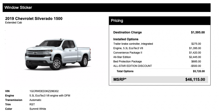

ChuckTaylor Posted July 25, 2019 Author Share Posted July 25, 2019 (edited) Unfortunately they had gas. My concern is from the other brands' diesels having wayyyy lower payloads - like 1200-1300lbs in Lariats. I found the attached truck (2WD DC RST 5.3) with a curb of 4935 or 271 less than the 2WD RST 3.0 that Mr Truck had. So I'm guessing the diesel adds about 271 lbs then. The 5.3 vs 6.2 seems to be about a 70 lbs difference as well which would make the 6.2->3.0 weight 200 lbs. CC/DC LTZ seem to run in the 5300-5400 range with 6.2s which would put the diesels in the 5500-5600 range putting the diesel LTZ right at about 1500-1600 payload. Still a lot of potential for error in my guess: I'm comparing a sample of one 3.0 RST to one 5.3 RST -- so plenty of opportunity for error there. And since I don't have any stickers on 5.3 LTZ without the Z71 I'm having to infer between those two. But it still looks like going with aluminum instead of CGI like Ford is paying off... Edited July 25, 2019 by ChuckTaylor Quote Link to comment Share on other sites More sharing options...

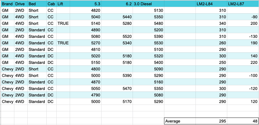

ChuckTaylor Posted July 28, 2019 Author Share Posted July 28, 2019 Newest GM order guide specs publish curb weights. Here are all the values from the Sierra/Silverado diesel variants and the 5.3/6.2. Last two columns are the difference between the Diesel (LM2) and the L84 (5.3)/L87(6.2) Interesting variation where the specs list the diesel losing up to 120 lbs vs the 6.2 in some cases and gaining up to 220 in others. According to this (suspect) data, the highest payload will be a tie for the 2WD and 4WD Crew Cab with Short Bed, followed by 4WD CC long bed (60lbs penalty). Also interesting: no diesel weights for lifted trucks listed... 1 Quote Link to comment Share on other sites More sharing options...

ChuckTaylor Posted July 28, 2019 Author Share Posted July 28, 2019 (edited) If these number are accurate, it looks like the LTZ would be around 1700lbs payload based on the average curb weights of LTZ I found. If that's the case, take my money now. If its below 1500, I'm probably going for a Ford or RAM HD truck for adaptive cruise. Edited July 28, 2019 by ChuckTaylor 1 Quote Link to comment Share on other sites More sharing options...
