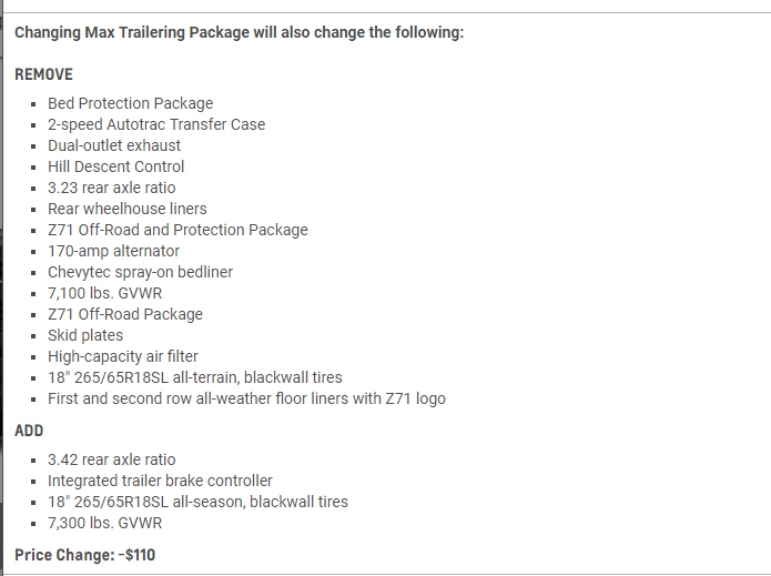

Belo Posted July 24, 2019 Share Posted July 24, 2019 per the other thread, i will also confirm my 4x4 rst z71 on 20's with max trailering handles and rides superb. Quote Link to comment Share on other sites More sharing options...
OnTheReel Posted July 24, 2019 Share Posted July 24, 2019 2 hours ago, Belo said: per the other thread, i will also confirm my 4x4 rst z71 on 20's with max trailering handles and rides superb. It’s one or the other. Can’t get Z71 and the Max Trailering package together. 1 Quote Link to comment Share on other sites More sharing options...

Belo Posted July 30, 2019 Share Posted July 30, 2019 On 7/24/2019 at 6:09 PM, OnTheReel said: It’s one or the other. Can’t get Z71 and the Max Trailering package together. fair enough. But i dont see anything that would drastically affect the ride quality when going from a z71 to max trailering except possibly the tires.. Quote Link to comment Share on other sites More sharing options...
