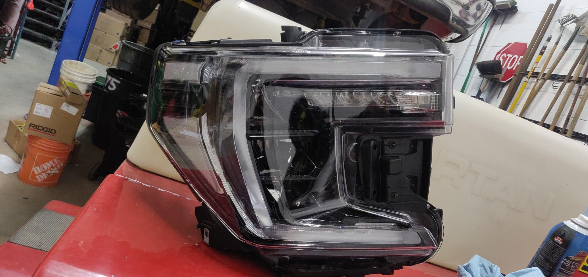

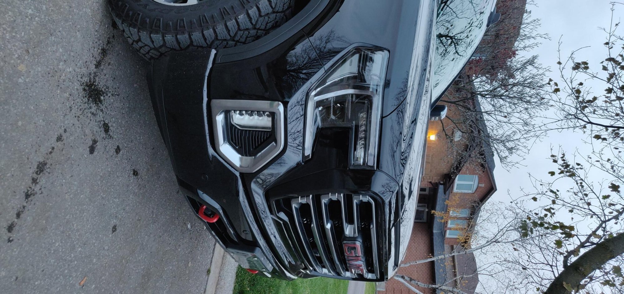

12 hours ago, luke1333 said:
Truck looks good! Did you do the clear reflectors on the headlights?!?
10 hours ago, Traction said:
More pics of headlights? you do them yourself?
Thanks. Yeah did them myself.. More of a pain in the ass removing the grill to get the lights out than it was to do the work. Used klearz lenses. Was torn between clear and smoked ended up going with clear kind of wish I went smoke to go with the all black look. Hopefully don't get scalded for posting these in this topic. Didn't take much with the lights apart unfortunately
  • Like 4
Will post another pic with details.

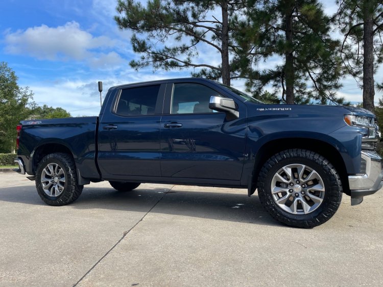

2021 LT 4x4. NO level and only minor trimming on the interior of the front mud guards. 35 x11.5 x 20 Nitto Ridge Grapplers. Drives fantastic.

Looks great and wish I would have known that before bumpers and grille got swapped on mine last year! 🤦‍♂️

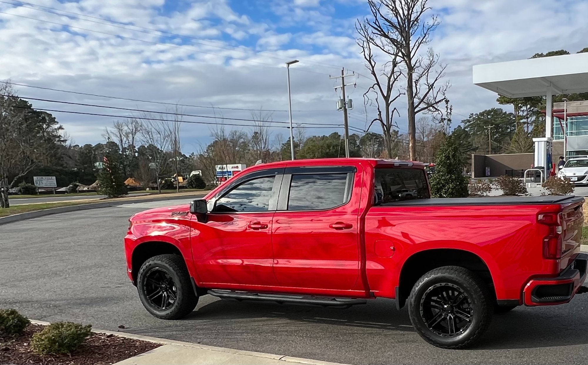

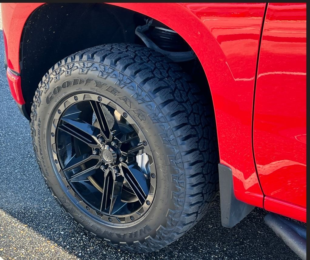

Stock suspension with Bilstein 5100 front shocks set to medium setting (0.6inches of lift), rear 2 inch block replaced with 1 inch block to lower rear 1 inch. Removed bracket behind mudflap to get rid of rub. Tires are Nitto Recon Grappler 35x11.50r20. Wheels are Factory Reproduction FR94 Trail Boss replica in gloss black finish 20x9 +15 offset
Looks good! How the recon grapplers road noise compared to stock?
So far great. But new tires always are lol. I had 22,000 on the 18" Duratracs and the noise was terrible. I think the Ridge has the best sidewall design of all the Grapplers but the Recon was more of a street tire which is what I preferred.  My first choice would have been the Exo Grappler with the 3 peak snow rating, being that I am in Michigan but I didn't care for the sidewall design. I am better off to get a dedicated snow tire for the winter anyway but I have driven on some snow and ice, so far so good.
