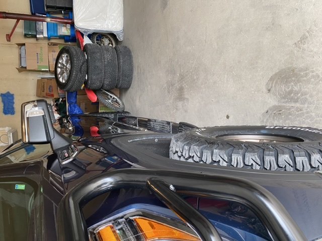

LTeddy Posted August 30, 2020 Share Posted August 30, 2020 Sent from my iPhone using Tapatalk Quote Link to comment Share on other sites More sharing options...

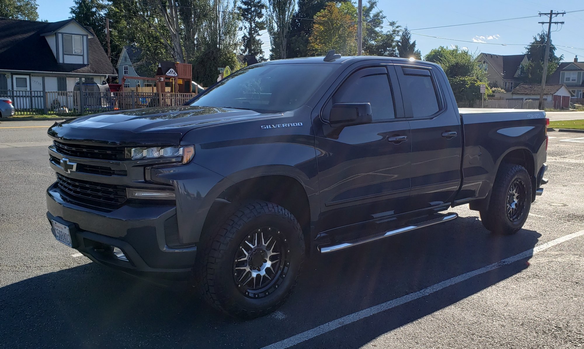

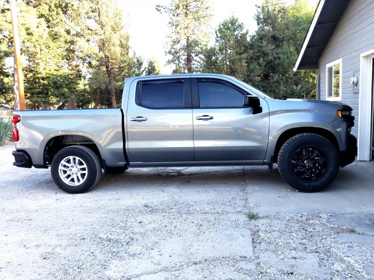

Northwestern Posted September 1, 2020 Share Posted September 1, 2020 (edited) I posted pictures on an earlier date but I got new tires. 2019 RST, 2 inch level, with Black Rhino Apache 18x9 and Cooper AT3 XLT 285/65-18. Edited September 1, 2020 by Northwestern Photo Quote Link to comment Share on other sites More sharing options...

LTeddy Posted September 7, 2020 Share Posted September 7, 2020 Is this stock height? Sorry if I missed a previous post. Sent from my iPhone using TapatalkYes it is! Stock trail boss height Sent from my iPhone using Tapatalk Quote Link to comment Share on other sites More sharing options...
