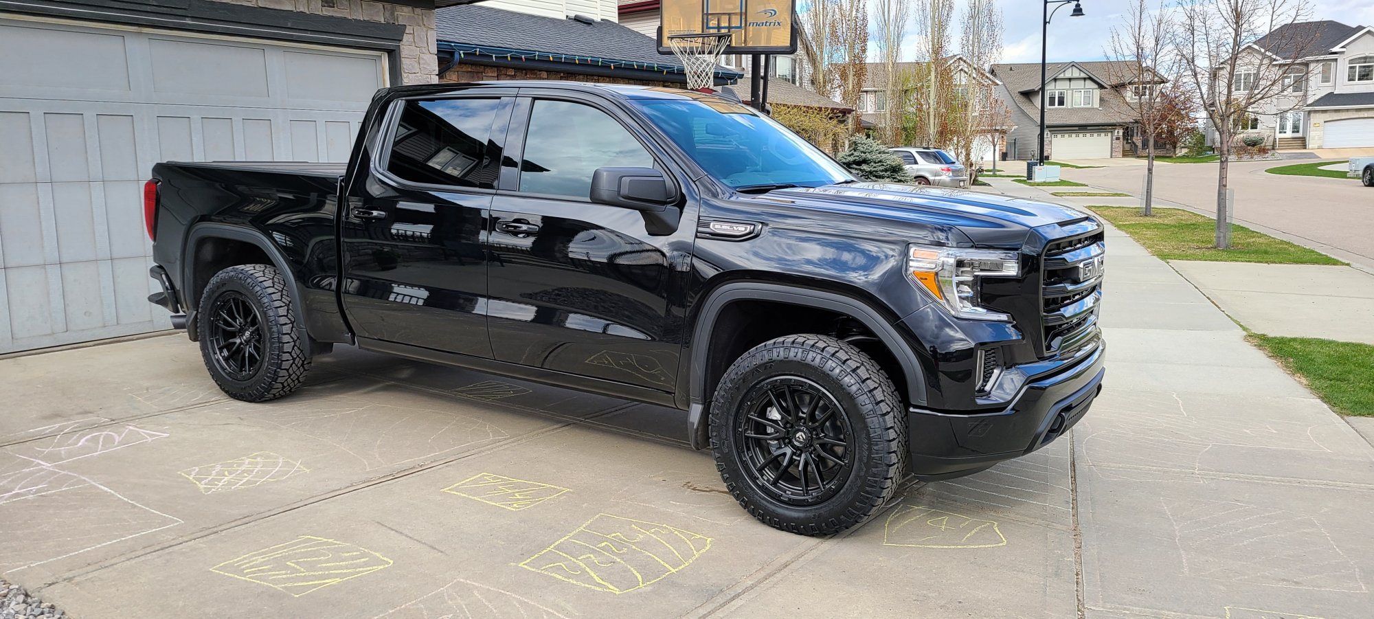

Got the rims a week ago and had intentions to run the stock tires for a bit. Couldn't handle the stock tires and pulled the trigger today on some Duratracs.
Stock size at 275/60/20. Crazy...but they rub a little bit on passenger side full lock in reverse.
Rims are Fuel Rebel 20x9 +1 offset.

So what's the tire size now?  And what leveling kit did u do?  I'm looking at the ready lift sst with those wheels n specs with a 305/55r20
