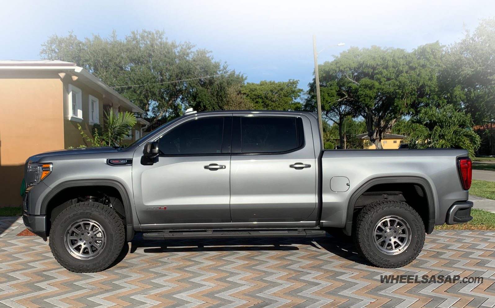

Here's my build
Specs:
  • 18x8.5 +0 Black Rhino Chase Rotary Forged in Brushed Gunmetal
  • 295/70/18 Falken Wildpeak AT3
  • ReadyLift 1.75" Level Lift
Very minor rubbing resolved with minor trimming. I created a post on our site of the trimming requirements for those looking to go with a larger set up on the AT4: https://wheelsasap.com/gmc-at4-oversized-tire-trimming-guide/

Thanks for this - great resource!!!
