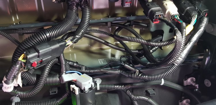

I still have some work to do on my wiring, as you can see from the pictures.  I thought I had some loom leftover from when I did this on my canyon, but I must have thrown it away.  It's in the mail though.

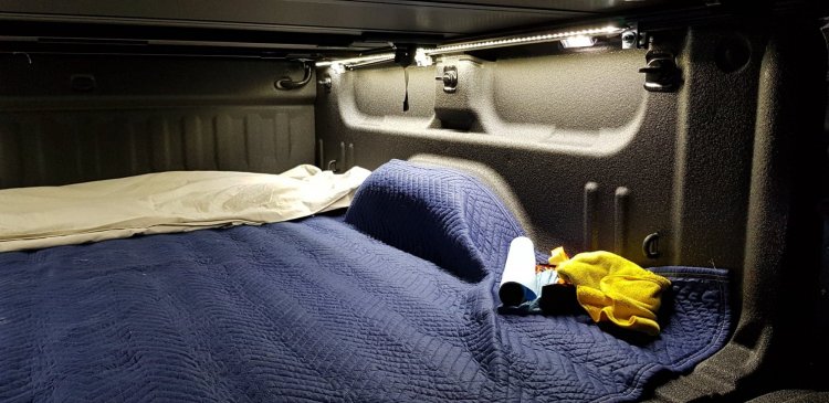

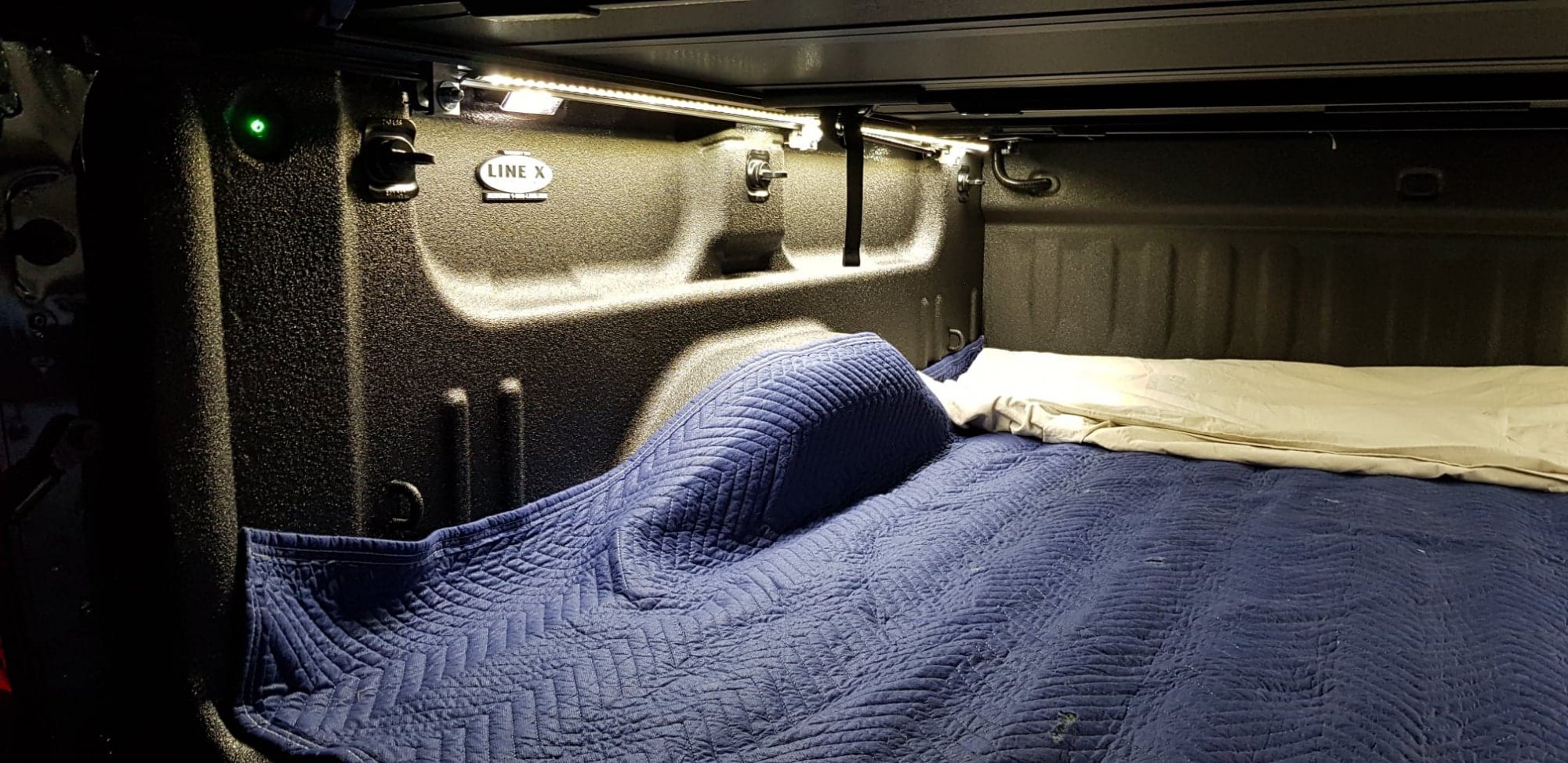

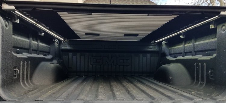

Thanks for the right up. I finally completed the mod and couldn't be happier. I did clean up the wiring and added 2 5' LED strips on each side of the bed along with the OEM bed light., just mounted them under the Bakflip side rails, very bright.

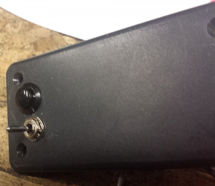

bedlight_left.thumb.jpg.2cdf25d365d2ddbb60408101af22913b.jpgbedlight_right.thumb.jpg.c8bdcd6808ca676ca1e48dead50d9a35.jpgbedlight_shot.thumb.jpg.a4e289f6312cdd6cfae1fd1997ca4d6e.jpgbedlight_switch.thumb.jpg.7d53b0ee2822cea50ef0e80d7d532ff9.jpgfinish_wireing.thumb.jpg.475e854d431c72c86c8354a9160c7b75.jpg

I finally have all the parts I need to do this, but my tonneau cover clamp uses the hole where you guys installed your switch. I’m thinking of drilling a hole down a couple inches but still within the stake pocket.

If you don't have any tie-downs, you could also modify one of the tie-down hole plugs to take the switch and use that location if you didn't want to drill a new hole.  Would be fairly simple to do, just drill a hole in the plug just large enough for the switch to fit through and run the wiring there instead.
You may have trouble getting the switch installed in a hole you drill below the existing hole in the stake pocket since it is a tight fit to be able to get your hand or pliers in to tighten the nut on the back of the switch to hold it in place.  Might be better off using the tie-down plug or even a SPDT toggle style switch under bed rail.  It would still be easy to get to, easy to wire, and be out of the way.

Unfortunately not.  However, you could do something like I mentioned in the post above yours.  If you are not using your tie-downs, you could modify the plug for the tie-down hole to hold the switch or you could use a SPDT toggle switch installed under the bed rail (where the lights would go).  Either of these would still provide easy access to the switch to give you light when you need it.
