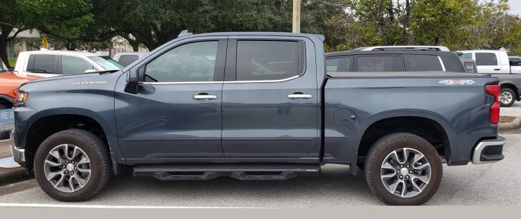

Readylift 2 inch level, sits 40 1/4 up front and 39 7/8 in the rear. Needs a small block in the rear to sit level. May go an inch at most.  I will get a new pic asap. Last week I did painted mirror caps, stock fog light gm kit, morimoto 2 stroke 2.0 led head light bulbs , gibson exhaust and airaid jr cold air tube and filter. Debating on 34 or 35 ll.50 20s.

Have you got it aligned yet? My 2” level Sierra was 1/4 high in the front at first, then after I got it aligned, it brought it down to level.
