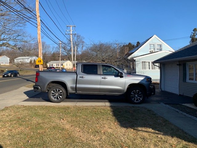

Finally got it back. turned out pretty good in my opinion. 35x11.50r20 ridge grapplers have just enough space between ball joint and tire. No rubbing no trimming. They do run a little small so same size trail grapplers might require a little trimming.
Hope to see more photos of this soon. recently bought a 2019 crew cab z71 rst and im trying to decide which level to use, but your truck turned out great Jmike
