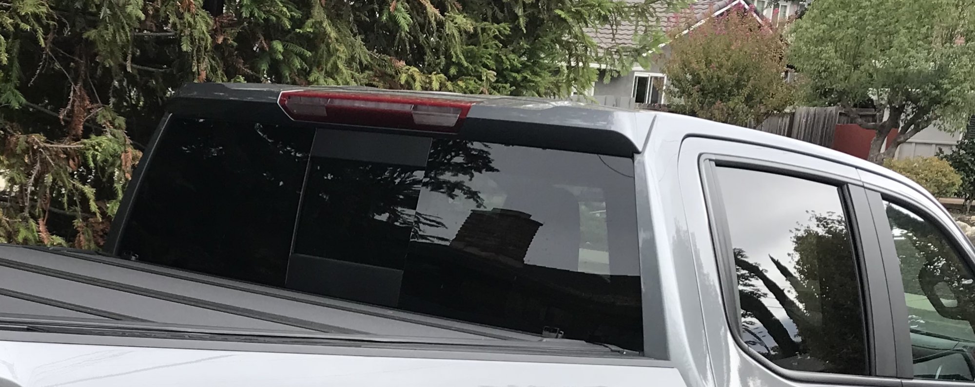

My 2019 Silverado does the same popping sound in the rear cab roof area.  Especially when the sun hits the cab as I’m driving and hit small bumps or driveway ramps.  I think it’s coming from the plastic air spoiler (for the lack of a better term) mounted on the top rear of the cab.  It’s annoying especially since I don’t even have 500 miles on it yet.  I’ll wait it out until the first service visit to have it checked.  I hope it goes away before then.

My "pop" has settled down to a "tick", maybe once per trip. And no sense bringing to a dealer because he can't change the laws of physics regarding different rates of expansion for different materials. And if he does by torquing the crap out of the retainers......no more pop......just one big snap as the plastic cracks.   Actually the redesigned spoiler with LED lighting tilting the light below the sports bar was a great idea as far as I'm concerned more than justifies an occasional tick or pop.
