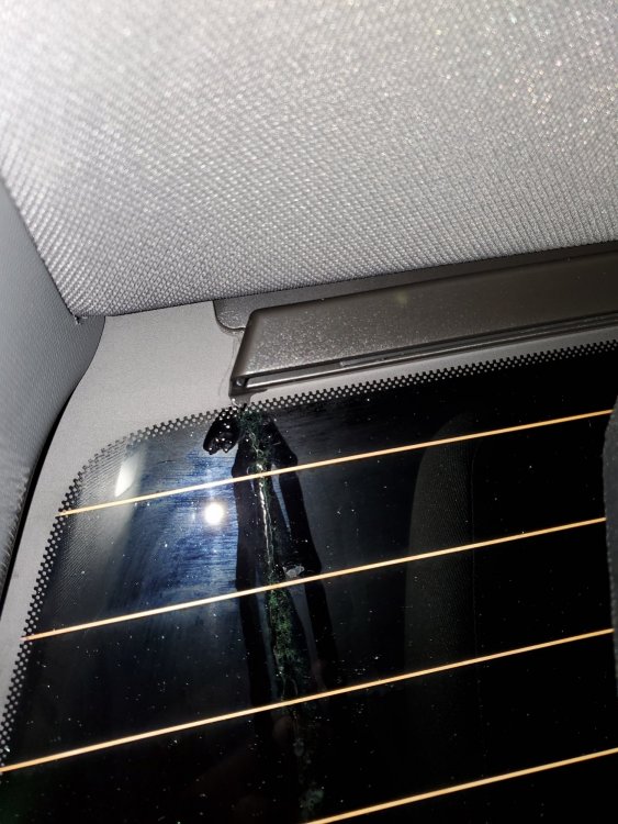

water leak on my 2019 RST (less than a month old)

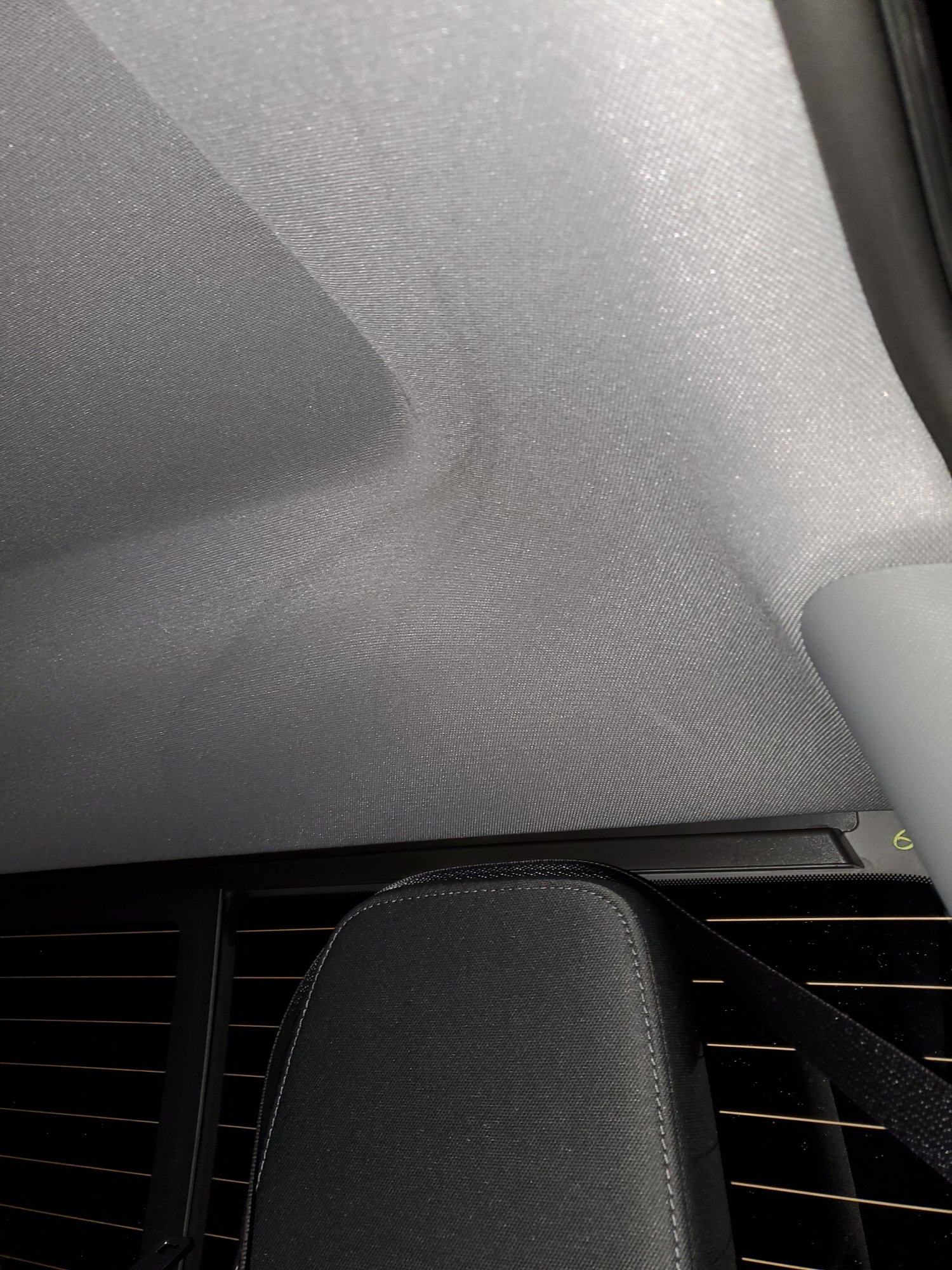

i just noticed a water leak on my new truck, i just got to the dealer service department to make a service appointment. While talking to the service advisor i ask him about whats going to happen with the headliner that has obvious damage due to water, he said they going to clean it and that they will not replace it with a new one. I wonder how soak my seats got before i noticed the issue.
there's any one that had this issue before that can give me guidance during this process that I already hate?

If you look into the large posting about rear window leak (abt 22 pages) it says that anything built before 10/18/18 is affected by the issue.  They went to a different supplier of the back window then due to issues with the previous suppliers windows.  Check that thread out, lots of info on what to do and what dealers are doing.   Good luck in resolving this with your dealer.

Check out the water leak thread on the main page for 19 trucks. I had similar water stains and they replaced my headliner but it requires the front window to be removed so pick your poison. If it only leaked once then I would let them try to shampoo first before gutting your truck.
There is a bulletin for this repair in the big window leak post. I would print it out and bring it with you to review with service advisor.

I know the feeling. Mine looked like yours except without the mold smell.
23 days later I got my truck back. Sealed window, replaced headliner and shampooed carpets.
