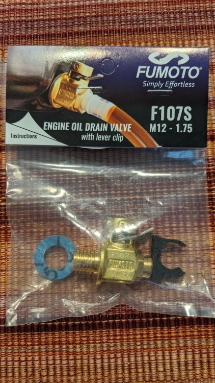

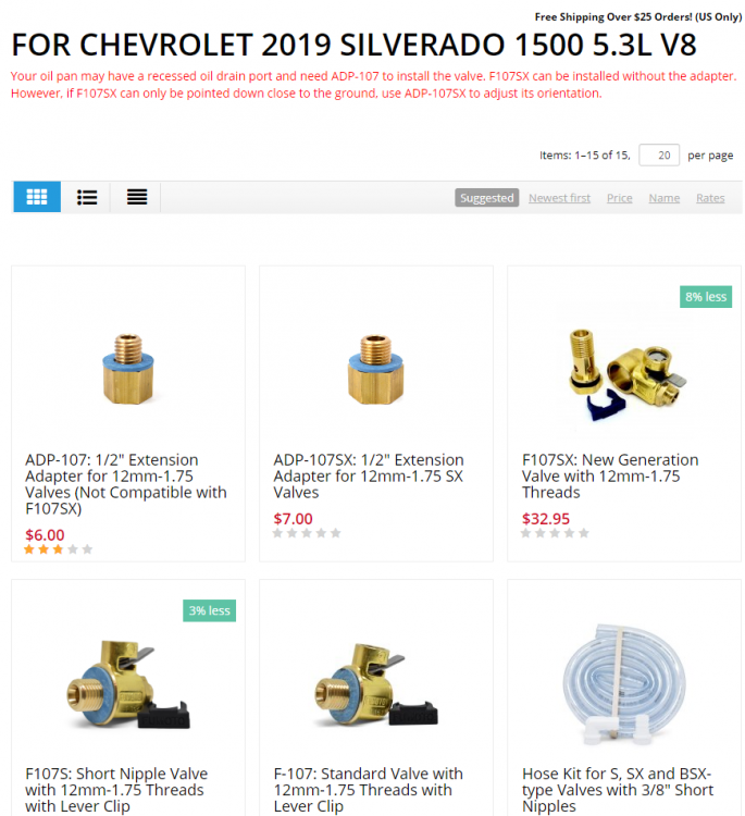

Anyone installed one on a 6.2 (2019 or is it the same as previous years)?
I installed th F107s on my 6.2. And the extension ADP 107 is not needed.
I have one one my 2019 6.2.  It's the same 107 used on the 5.3.  I use the F107N and attach a 12 inch piece of clear vinyl tubing.  I've been using the Fumoto for decades on every vehicle I own and I've never once had an issue with any of them.
