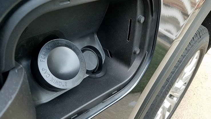

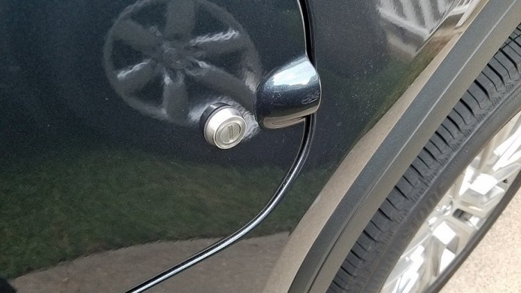

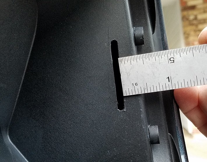

I ran across this thread and I am like a few people, capless fuel is fine, but really no basic locking mechanism for the fuel door. All it would have taken was for GM to install a solenoid locking system in conjunction with the door lock and unlock circuit to make it happen. So, without a major design and mod for a locking fuel door here is what I came up with. If you like it or dislike it, it doesn't matter to me. My OCD is now relaxed knowing the fuel door is locked. The parts you need will be a JR Products 00175 Compartment Door Key Lock - 1-1/8", $11.87 on amazon, a 2" FERNCO rubber cap from Home Depot to keep the dust out and finally a 70K GMC Sierra Denali, local dealer. Oh, the locking cap GM sells is junk, since it is easily removable by flexing the housing and it pops right off.
Another thing, the door facia or applique comes off very easily by lifting the tab, it comes off with a little force without moving the tab, it is 92.00 part from GM un painted, the hinge mechanism and well is 20.00 from GM. If I was one of those neighbors I can add a collection of fuel doors already painted and ready to go for EBAY.
Installing the cam lock as gaudy as it may look for some, it actually secures the door to the hinge assembly. You would have to remove the lock to remove the door.
