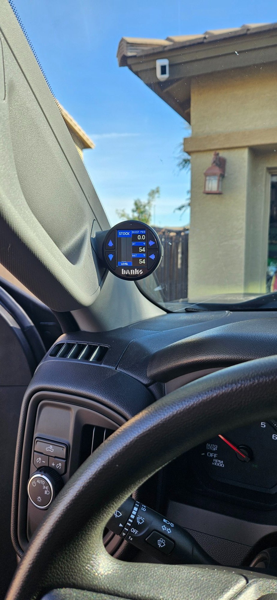

Yup, 99% sure it will give me oil temp. Ill check this afternoon that it does and set that as a saved cluster and get some #'s the next time I'm out for a bit.
Thanks!  Clean setup. I also have a custom.
Interestingly, I don't think they put a oil temp sensor on these. I can get dam near everything else but oil temp.  Im gonna follow up with Banks though just to make sure I'm on the right config vehicle wise and if maybe doing the 3.0 diesel will give me more monitors. Right now it's just GM and sync'd with the base GM ECU settings.
