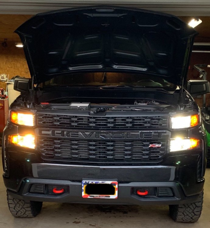

I just installed a 4 piece set of LED lights from Sealight on my '19 Silverado Custom Trailboss.
Just make sure you buy mini or low profile bulbs as most of the LED bulbs have the large cooling fans with heat sinks mounted on the back of each bulb and you won't be able to reinstall the dust covers.
Whatever you buy, make sure the bulbs are low profile as there's not as much room directly behind the bulbs like on previous years.
My '14 Silverado Rally 2 I just traded in had room for the large cooling fans on the rear of the bulbs. But this isn't the case with the '19's.
These are the ones I just installed in my truck.
I bought the 9005/H11 4piece set.
What a difference in color and brightness.. 110% better.
https://www.amazon.com/gp/product/B07MNG5S5P/ref=ppx_yo_dt_b_asin_title_o00_s00?ie=UTF8&psc=1
Hope this gives you an idea of what you need to change your headlights out.
In the photo the left are the stock bulbs and new LED's on the right.

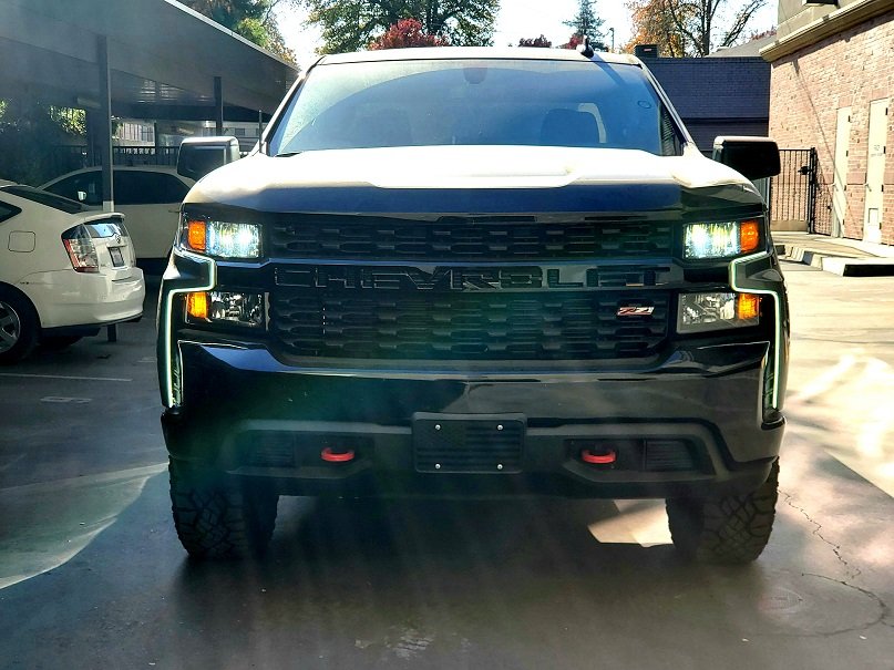

Anyone able to find a complete aftermarket headlight assembly that has integrated LED's similar to the LT? I know companies out there like Alpharex do this, but they don't seem to have one for the 2019+ Silverado's...maybe next year, but just thought I'd put it out there.
