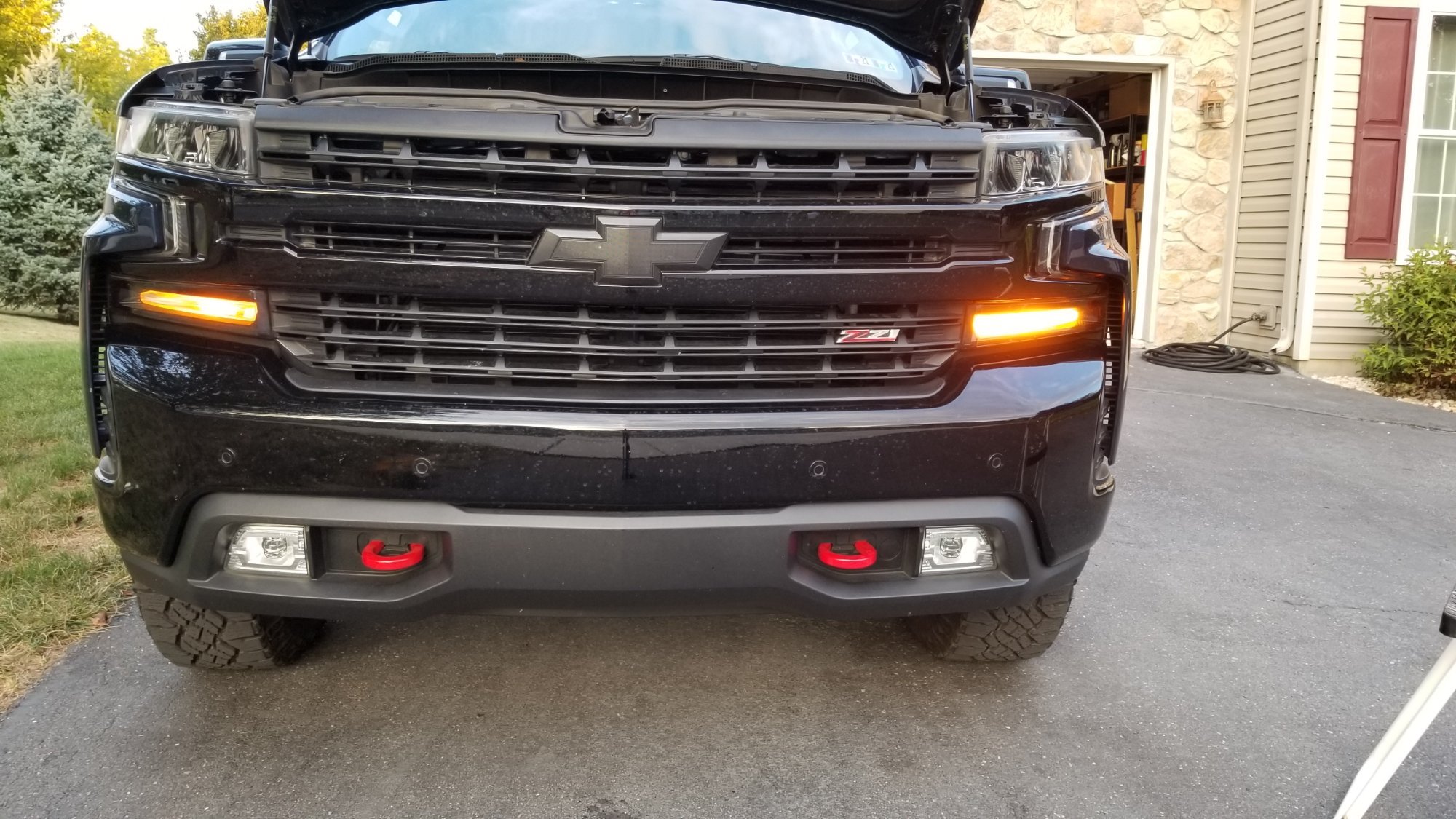

I have the Lasfits. Seem to be working fine. Attached pic of stock (passenger side) versus Lasfit doesn't do them justice. No hyper flash, I believe they have the resistor (or some sort of magic) built in. Have had to add resistor to wiring in the past. Much nicer to have it right in the bulb.
