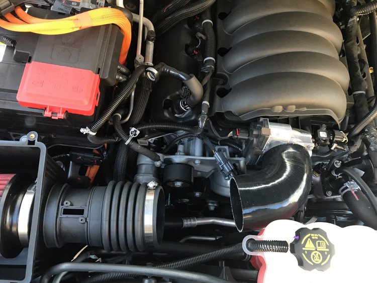

@3tspapat Which CAI did you make fit if you don't mind me asking?  Would love to look at getting one put on the truck.

@IncisionInd I got the GMPP CAI to work. Just had to do some cutting and then a 90 degree reducing elbow. Just getting that elbow to clear the coolant overflow (or just extending lines and mounting the overflow to the open area where the old battery used to be), you would be able to get any CAI to work.
I'm on the fence on buying a monitor to see what the the difference this thing has on performance. Just general stuff like timing, knock, etc. at WOT and while putting around. eAssists are a bit weird. ECU is programmed to keep the vehicle in lower gear and use the e-motor when accelerating in same gear and also use e-motor to keep the vehicle in V4 longer. Gotta tune that crap out, drive in L7, or drive in L7 and tow mode.
