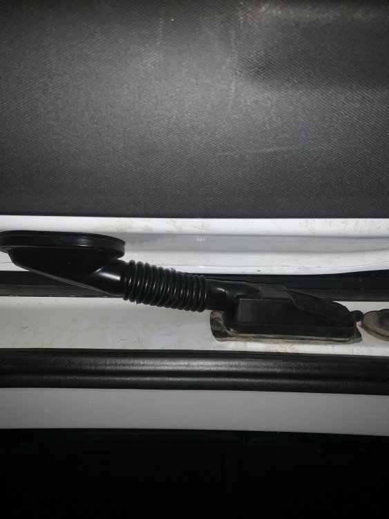

I found out the issue y’all! The connector between the lift gate and the vehicle had some corrosion in the connectors. Took it apart, cleaned it, and it’s back to new. Thanks everyone for the feedback. Hopefully this helps someone out in the future
  • Thanks 1
Lift gate, or lift glass?
If you have a picture that will be grate, at least from the internet (spare parts database)
The connector is attached from the vehicle at the lift gate opening to the lift gate, at the top of the lift gate. Lift glass was the only that kept popping open on me. I suppose the lift gate could do the same thing, however in my situation it was only the lift glass malfunctioning.

Try investigating the plug that Josh_2015burb showed in the post above.  Perhaps yours has some corrosion in it too causing issues?
