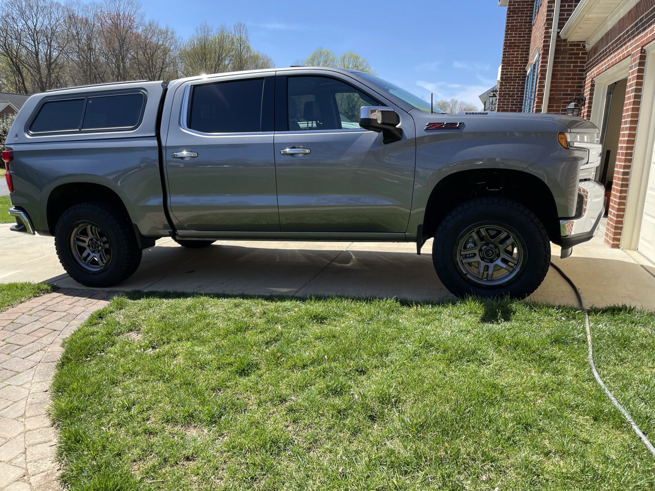

4.0 Inch ReadyLift kit.... Thoughts?
32 minutes ago, GoDj1978 said:
Are you using the factory wheels and if so what size wheels and tires are you running, also did you have to use the wheel spacers if so?
Aftermarket wheels: 17x8.5 (0 offset) with 35x12.50R. No spacers. Only rub at nearly full lock in reverse.
